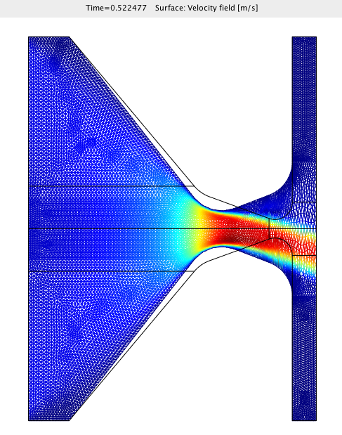

Try using Heaviside functions on your pressure to ramp it up to the final value. In your inlet pressure I used P*flc2hs(t-0.1,.1), and I got the following result (attached screenshot).
[QUOTE] Sorry, I attached the file. Regards, Hani [/QUOTE] Try using Heaviside functions on your pressure to ramp it up to the final value. In your inlet pressure I used P*flc2hs(t-0.1,.1), and I got the following result (attached screenshot).

Thank you very much. In fact I have tried that as well. I made a ramp from time zero to 2, that the pressure reaches 300 and from t=2 to t=3 pressure is constant p=300. Again the cycle is not completed and it crashes at time 2.67. The file is attached.
What about the model that you tested, as far as I see, it has crashed at t=0.52. Am I right?
The other possibility is to make the channel longer after the moving parts in order to reduce the effect of outlet on the fluid. But again in that case, I could not get any result....

No it didn't crash; I just stopped it, as I was running it my laptop.
I will try again today and report back
No it didn't crash; I just stopped it, as I was running it my laptop. I will try again today and report back

I tried some more simulations, and I can say so far that mesh around the neck is a very important part. So I refined the mesh in that area and I could simulate a bit further. How about you draw the mesh quality and improve the parts that goes low.
Hi Hani, I tried some more simulations, and I can say so far that mesh around the neck is a very important part. So I refined the mesh in that area and I could simulate a bit further. How about you draw the mesh quality and improve the parts that goes low.
