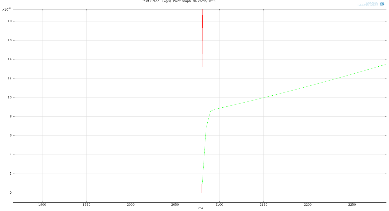

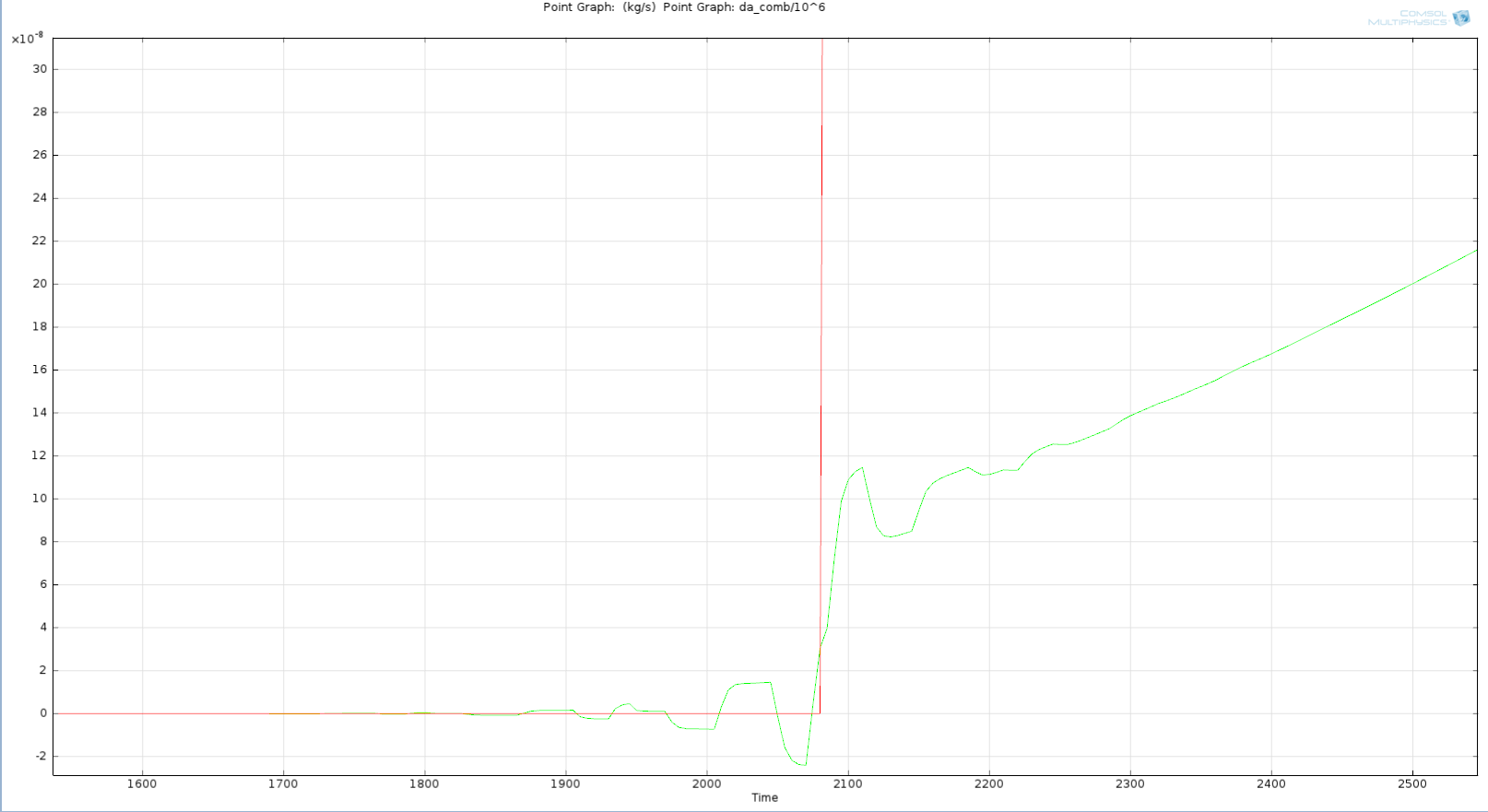

PS.
I included 2 graphs. The first shows the result of the first equation (unstable), the second shows the results from the second equation (smooth), green is the funcion in question and red is the activation of the conditional statement.
