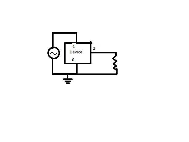

Thanks for the reply. I think I haven't disturbed the Ground node.
I have attached a small prototype of my design, the 'device' is my multiphysics model and i need to interface it with Electrical Circuit connections.
As per the diagram, in my physics model I have declared terminal 0 as ground. Terminal 1 and 2 are of the terminal type 'Circuit'.
In the Electrical Circuit (cir) node, I added a Ground node with node name '0'.
I added an External I-terminal 1 with node name 1 and Electrical potential as term1 (terminal voltage from drop down).
I added an External I-terminal 2 with node name 2 and Electrical potential as term2 (terminal voltage from drop down).
I added a Voltage source between node names 1 and 0 and Source type as AC.
I added a Resistor between node names 2 and 0 with value 100 ohms.
Is there any need to use External I vs U ? What mistake am I doing here ?
Thanks.
Sneha
Hello, Thanks for the reply. I think I haven't disturbed the Ground node. I have attached a small prototype of my design, the 'device' is my multiphysics model and i need to interface it with Electrical Circuit connections. As per the diagram, in my physics model I have declared terminal 0 as ground. Terminal 1 and 2 are of the terminal type 'Circuit'. In the Electrical Circuit (cir) node, I added a Ground node with node name '0'. I added an External I-terminal 1 with node name 1 and Electrical potential as term1 (terminal voltage from drop down). I added an External I-terminal 2 with node name 2 and Electrical potential as term2 (terminal voltage from drop down). I added a Voltage source between node names 1 and 0 and Source type as AC. I added a Resistor between node names 2 and 0 with value 100 ohms. Is there any need to use External I vs U ? What mistake am I doing here ? Thanks. Sneha
Posted: 1 decade ago 2012/05/04 14:42 GMT-4
Thanks.
Sneha
Yes you need External IvsU (or UvsI depending on your 'device'). Otherwise comsol can't pass the potential/current of the node between circuit model and multiphysics model

I do not believe this is flagged as an "error" but normally you do not need to define a terminal ground, you can directly set the BC to GND via a GND BC of your physics. Then the defult GND = node 0 of the circuit physics will be connected to your physics GND by default. asically you need only 2 terminals.
Indeed you need either IvsU or the opposite depending on the physics and related deepnet variables choosen, If the Terminal is set to circuit and the IvsU or UvsI show you the drop down list of terminal 1 and terminal 2 then its the correct one. But your IvsU node must also refer to CIRC node 0 for gnd and 1, respectively 2 for the other connection
Check the model library for "CIRC" and train with the examples therein

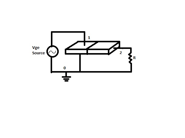

I checked all the connections, added the External I-vs U connections, I still get the same error 'DAE is structurally inconsistent. Error in automatic sequence generation'.
My device is basically a three terminal piezo transformer, where i want to apply an AC voltage to the input terminals for varying frequencies and connect a resistor at the output terminal. The input an output terminals have a common ground. The pictorial representation is as shown in the jpeg file attached.
And my model is as attached. After declaring the circuit connections, I am trying to do a Freq Domain study since I want to vary the input frequency to the transformer.
Any ideas what might have gone wrong? Thanks a lot!
Sneha

I rearranged your circuit nodes based on your .jpg diagram and how they made sense to me- although there are usually several "correct" ways rather than just the one . Seeing as your model has three terminals, and you need to define four in the circuit, I believe the two terminals need to share a node. External I vs U should be correct for both piezo terminals.
Let me know if the attached solution is what you were intending. Note: I ended up using MUMPS at the solver. PARDISO was default and was having convergence issues.
Thanks for sharing this problem, it is an interesting one. Do you mind if I ask the application?
Marc
