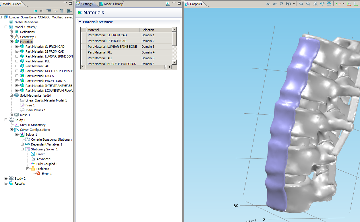

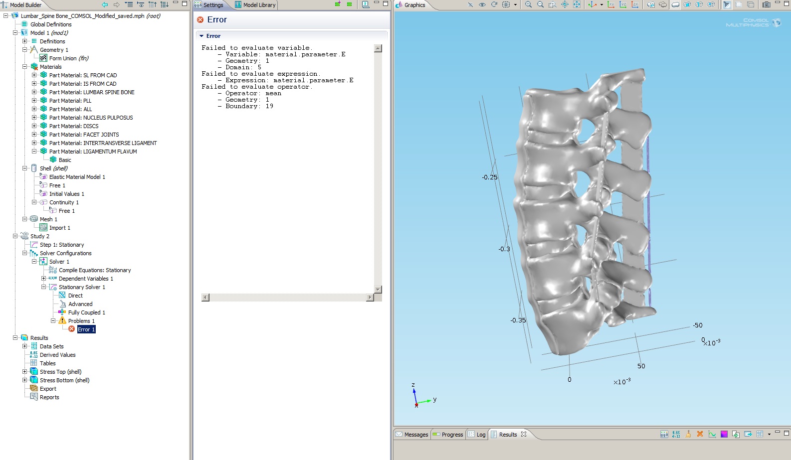

Perhaps its one of your physics settings that is set to User defined E modulus instead as "From material", or it's one of your materials that does not have E defined, (or you material is anisotropic, then you need to define the full tensor) or some domeain (5) is not linked to any material ? Or one of the numbers is not typed right, or even you are using an equation that is not fully defined, typo or undefined variable (this is not so likely, as COMSOL should have told you the variable name)
There are many combinations possible for such error

                                                    Thank you so much for the reply.
I tried to look out for all the different situations where one would go wrong, but still i'm unable to figure it out.
What kind of physics setting is best suitable for a model  like LUMBAR SPINE. Like if i wanted to work on biomechanics and kinematics of the model. Please help me understand these things better and make a best use of COMSOL.
