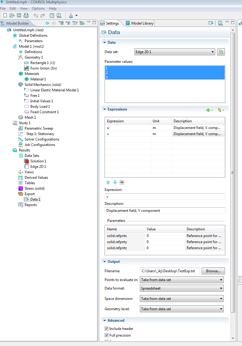

try the following:
Data Set edge or surface or cut line, plane ...
Right Click export
Define the variable(s), the interpolation, the format, file name ...
Export F5
Hi try the following: Data Set edge or surface or cut line, plane ... Right Click export Define the variable(s), the interpolation, the format, file name ... Export F5 -- Good luck Ivar

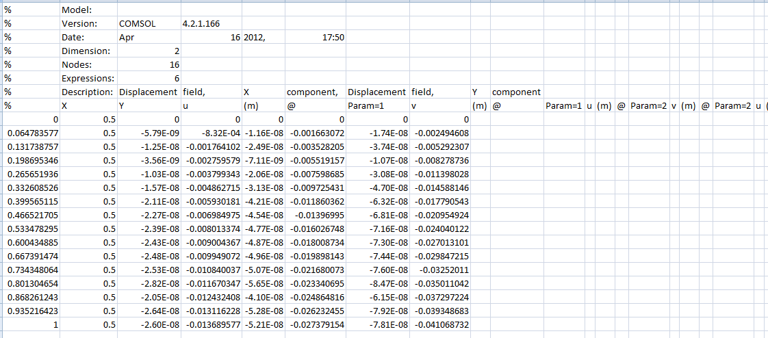

Posted: 9 years ago 2016/12/20 16:51 GMT-5
Hi Ivar,
I ran your file (changed the export data destination) but it did not export the data after simulation was done automatically. I had to press 'Export' manually to export the data file. How can I have the file after simulations exported?
