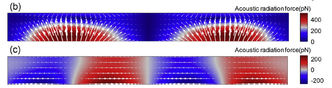

I am modeling acoustophoresis phenomena caused by the propagation of surface acoustic waves (SAWs) to separate particles in a fluid. I am trying to reproduce the results of this article (www.sciencedirect.com/science/article/pii/S0021979715004658?via%3Dihub).
I am not able to reproduce the plots of the acoustic radiation force (components along X and Y direction) (figures 3.b, 3.c in the article). I can plot the acoustophoretic force on the particles, but I am not able to plot the force on a surface as in the article. How can I do that?
(I uploaded the pictures showing the plots that I am not able to reproduce).
