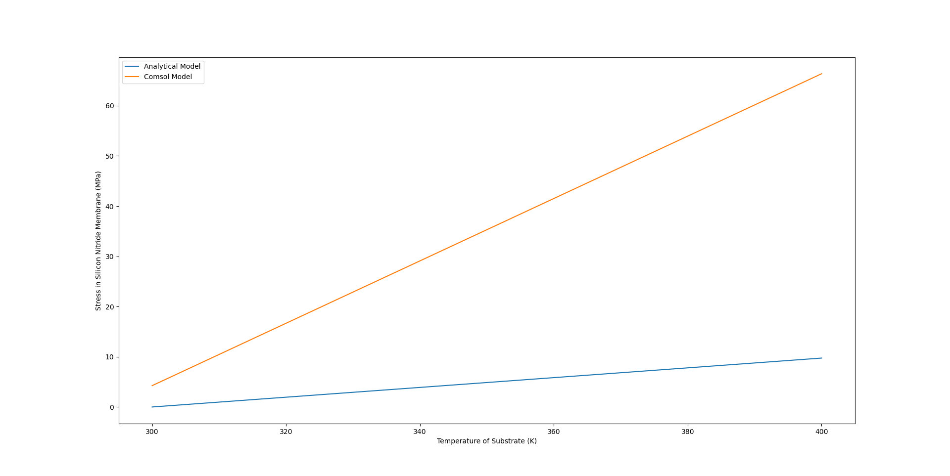

But when I do it in Comsol, I get a curve going from 4.25 to 66.36 MPa which is a considerably different and bigger
As you can see in this image that provides the curve I get analytically VS Comsol, there is quite a big difference. (See Attachment: CurveComparison.png)
Would anyone happen to know why? I am pretty sure I have messed up the simulation in some way because I am confident of the analytical model.
