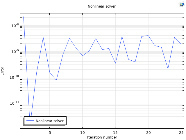

I took your rotatinal_blade.mph from the Application library that makes use of 'Rotating Frame' to adapt my model. However, I often get the Error: "Failed to find a solution. Maximum number of Newton iterations reached. There was an error message from the linear solver. The relative residual (0.0065) is greater than the relative tolerance. Returned solution is not converged. Not all parameter steps returned." The convergence plot of the nonlinear solver is added below. I was figuring out I can avoid the error if I either turn off the centrifugal force, or if I model an annulus with a hole at the disc centre. So far, an annulus with fixed boundary at the hole is sufficient as a starting point and since I am excluding the axle. But in a later study, I might want to include an axle and hence it would be important to have a model that works without the hole.

Since there are no constraints, the stiffness matrix for the stationary study step will be singular. You must constrain the disk at the center.

Dear Henrik,
thank you very much for your quick response, makes very much sense. I did not pay much attention on the stationary study, when thinking about the problem. I now added a constraint at the disc center in the stationary study only, not in the Eigenfrequency study. Works perfectly fine now, thanks for the help.
