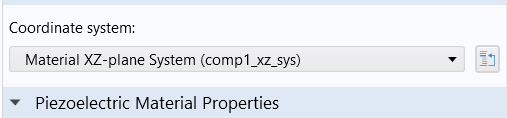

2) Why in the piezoelectric material interface, under coordinate systems, "Material XZ plane system" is selected? If the properties are already related to the YZ LiNbO3, I think that "global coordinates" has to selected, or I am wrong?
3) Why "Material XZ plane system" and not "Material YZ plane system" is selected?

Interesting question. It appears that the posted model uses a custom set of parameters for lithium niobate. If you look at the Comsol built-in parameters for lithium niobate you will see that c11 = c22 < c33 as expected.
This helps explain the choice of the plane system.
By the way, when using the built-in LiNbO3 parameters, I think you want to use the ZY plane system to get what you want (YZ means Y-face, Z-propagating). You can sort this out by looking at the definitions of the coordinate systems and it is advisable to verify that you get the right velocities.

I want to model SAW device for acoustophoresis and the piezoelectric material is YZ lithium niobate. I notice that because the "saw gas sensor model" and the article (from which I have to reproduced the example) take the material properties from the same reference that I indicated in the first post.
So I use the same setup present in the "saw gas sensor model", and I don't think that I can use the built-in comsol parameters for lithium niobate. I thought to use "global coordinates" under the coordinate selection section, but maybe I am wrong.
How I can verify that I get the right velocity?
Thanks for the help. I want to model SAW device for acoustophoresis and the piezoelectric material is YZ lithium niobate. I notice that because the "saw gas sensor model" and the article (from which I have to reproduced the example) take the material properties from the same reference that I indicated in the first post. So I use the same setup present in the "saw gas sensor model", and I don't think that I can use the built-in comsol parameters for lithium niobate. I thought to use "global coordinates" under the coordinate selection section, but maybe I am wrong. How I can verify that I get the right velocity?

The Eigenfrequency calculation gives you the frequency corresponding to a particular wavelength, so c = f*lambda.
Working out the orientations for anisotropic materials gets tricky. There's no alternative to thinking carefully about what you are doing and checking...twice...or more. It gets worse for multiply rotated orientations.
