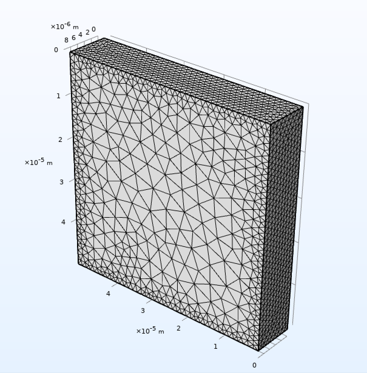

Hi, I am solving a problem in Comsol using the Structural Mechanics module and **need to know how to adjust the size of a 3D mesh on 1 domain to make it finer for some areas and coarser for others.
I have a rectangular prism with dimensions of 50 um x 50 um x 10 um. There is a fixed constraint on one 50 um x 50 um face and a 1MPa load on the other 50 um x 50 um face. There are 2 periodic boundary conditions on the remaining 2 face pairs.
I created a Free Tetrahedral mesh using a .625 um element size, but the problem is too large for my computer's memory.
The attached file "simulation," has the full simulation set up.
**Is there a way to adjust the 3D mesh so that it is coarser on the larger (50 um x 50 um) faces and finer on the 10 um x 50 um faces?
The attached picture shows what I would like to do using a Free Tetrahedral or other 3D mesh. Note that I actually achieved this picture using Free Triangular meshes, which are not suitable for my 3D problem, I just did this for the sake of illustrating what I actually want. Thank you!

Posted: 5 years ago 2021/02/28 19:15 GMT-5
This is straightforward to do. Just use a user-defined mesh and specify different size constraints for the domain and the faces in question. See my attached, and only slightly-modified, version of your file.
