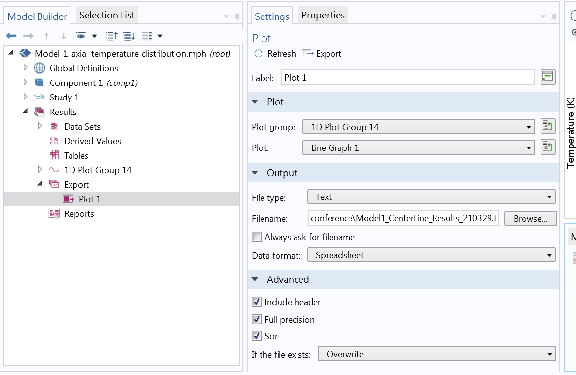

You can control this behavior in the Export > Plot node: Set If multiple curves to Append as columns.
Thanks for your reply Gunnar. I don't see this option within Export > Plot node. Maybe this could be due to my older version (5.3a)?
>You can control this behavior in the Export > Plot node: Set **If multiple curves** to **Append as columns**. Thanks for your reply Gunnar. I don't see this option within Export > Plot node. Maybe this could be due to my older version (5.3a)?
Posted: 4 years ago 2021/03/30 1:16 GMT-4
Yes, I don't think that that option was available in 5.3a.
