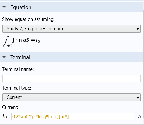

Howdy,
I have been working on a simulation where current is being injected into a medium through two electrodes. I realized that the current I was injecting was DC current. How do I inject AC current? I have the AC/DC module. I am currently trying to use a terminal to inject the current and putting a sinusoidal equation but keep getting errors. Any help is appreciated

When working in the frequency domain (which you seem to be), you don't specify a time domain style input of a sine function to represent the current. Instead, you specify a frequency and a port or other boundary condition (there are various options available) to launch the current. I think you may find some helpful examples in the applications library.

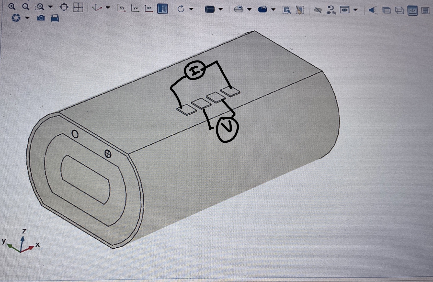

Howdy, Thank you for that. What I got from the application was to use the Magnetic and Electric Fields physics to add a Lumped Port. Currently the simulation I am running is an Electric Current Physics with a Terminal and Ground to inject current and two voltage probes to detect voltage difference (See picture attached). Is the only way to add an AC current through the Magnetic and Electric Field Physics? When adding that physics it requires me to put permeability which is not a material property I have at the moment. Is there not a way to add the AC Current through the Electrical Currents physics? My apologies if some of this is a bit repetitive, I felt I didn't give you a clear explanation of the project upfront.

If you are not using magnetic materials, you can usually just set the relative magnetic permeability = 1. In regard to other ways to specify AC ports or boundary conditions, I believe that several exist. What works best in one application may not work so well in another. I encourage you to experiment with the options available to you to see what works. Also, perhaps some others on this forum can offer other more specific suggestions and examples. Good luck.
