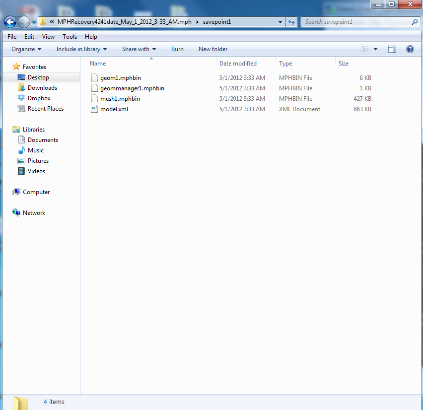

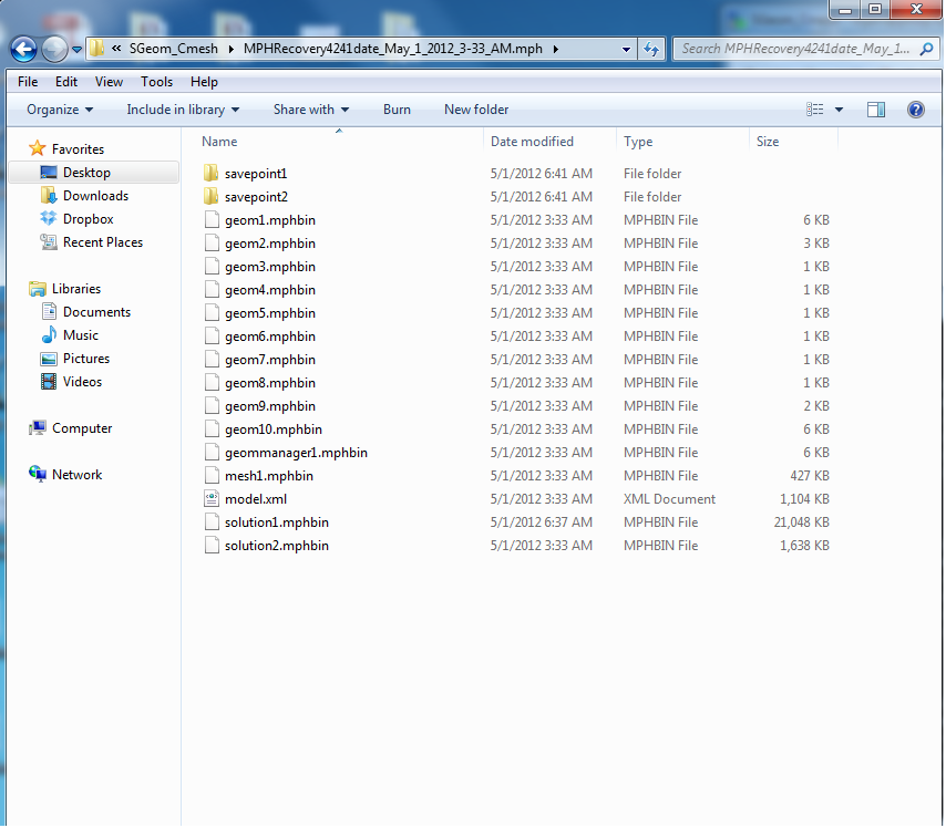

On linux cluster, i am running comsol in batch mode and all i get is the recovery folder with no .mph files but .mphbin files for mesh, solution, geom etc. The data is there and the size of sol1.mphbin increases dynamically as solver moves on but in the end, i can not extract the .mph models.

                                                    Hi Mranal,
I encountered the same issue that I can locate the recovery file folder with multiple files as you showed in the pictures but it doesn't show in my "Open recovery file" list.
I am wondering did you figure out how to extract those files from the folder, if so, do you remember how you manage it.
