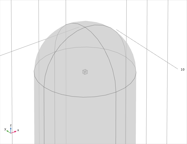

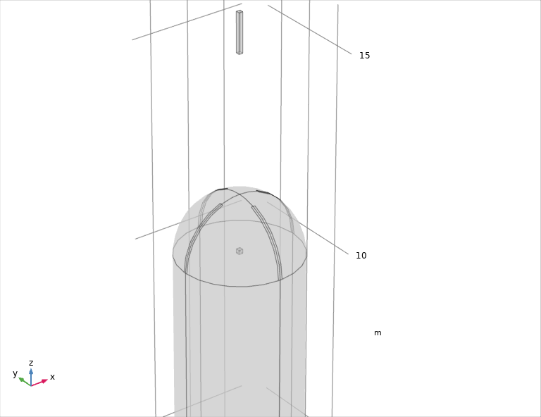

I have thicken the strip and want it lying on the surface of the sphere but am not successful. Is there a way to heighten the strips without compromising the geometry design?
Could you show me an example with version 5.4 ? As I could not open your attached mph file with an outdated version.
Attached is my mph file of my model. Maybe you could use my file as an example. V1 is an updated model for better visualisation with thicken strips. However, I could not make the strips lie on the surface of the outer sphere for this model.
