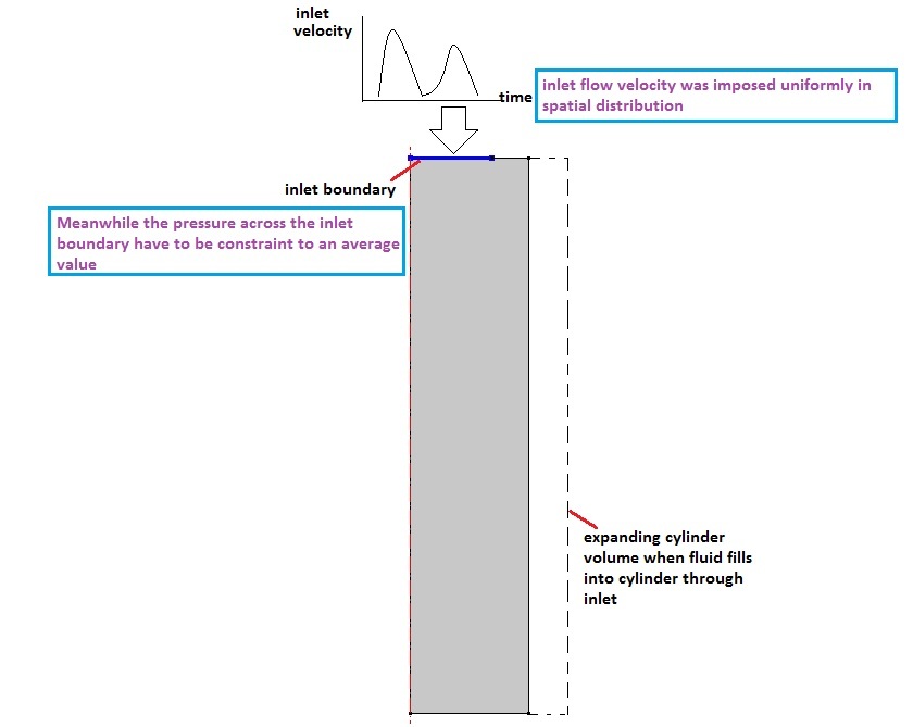

I attached cylinder_inlet.jpg and my .mph file for more detail description. In the model, the fluid flows into cylinder and its volume expansion was prescribed through ODE equation.
In this fluid flow case, the pressure at the inlet boundary will be calculated automatically from the imposed inlet velocity through built-in Navier stokes equation. So in order to constraint the average pressure at the inlet boundary to 20, i add a weak constraint to the inlet boundary however i get this error:
Singular matrix.
There are 1 degrees of freedom that do not occur in any equation (empty columns in matrix) for the variable mod1.lm.
at coordinates: (0,0), ...
Can u please take a look the attached .mph and give me some guidance?
Thanks again.

in all generality, any BC defined at a level 2* lower than the domain level: 2D Surface => Line => (Point/Vertex), or 3D volume => Surface => ( Edge => Point/Vertex) tend to give singularities.
Then in CFD an "inlet", as the "outlet" are "names" you can get localy flow "out" of an "inlet" boundary, so long the overall flow condition is respected as a mean over the boundary (slightly BC setings dependent), and the opposite for the "outlet". So respecting and average inflow and positive pressure increase over the full inlet BC gives a different result as the single point restriction
