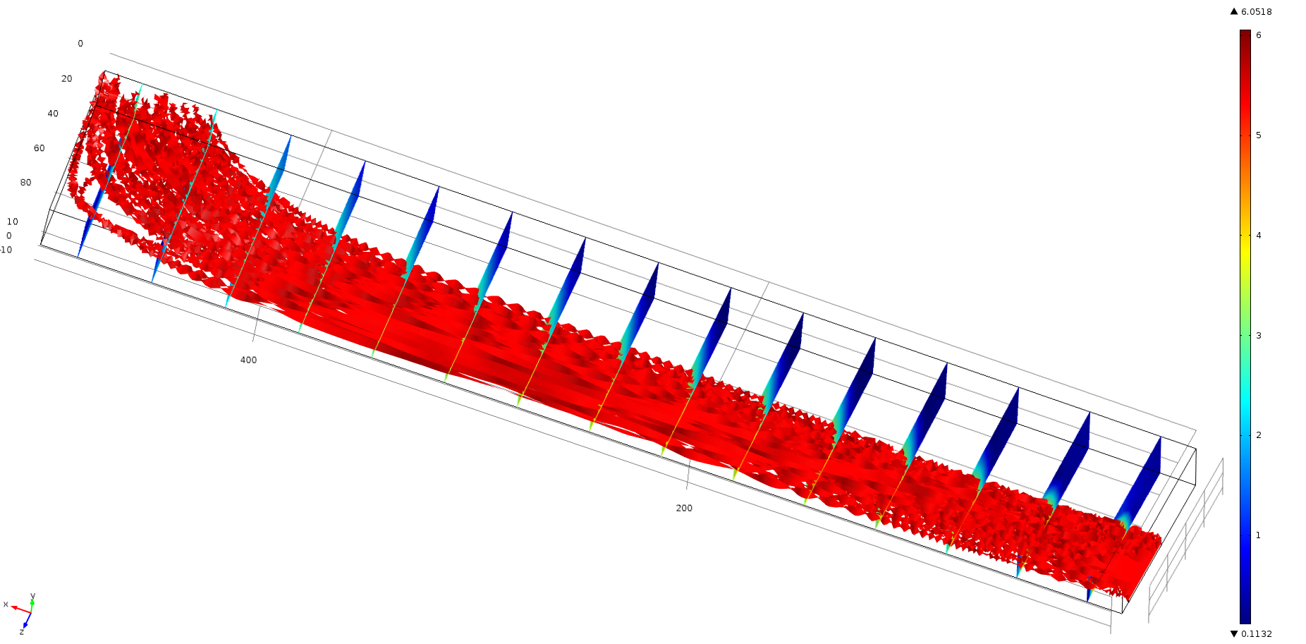

Nevertheless, when I utilize your model, whatever pressure I set at outlet, the flow profile doesn't change (it seems to only bias the whole solution).
Another problem I found is that in this model : there is always a "backflow" into the chamber next to the inlet, while measurements show no such a behaviour. I have an outlet flow velocity profile measured:

I think you are right about the documentation. It took me a moment, but finally I have reached to the point, where I know what I am looking at.
As I mentioned above, I decided to use "Boundary stress" with "normal stress, normal flow" condition and :outlet: boundary type.
Now I am pretty sure, that my boundary resembles an array of fi 1x10mm holes. Nevertheless I still get solution which is way different from measurement data, as I described above.
Do you have any suggestions how could I get them more close to each other?

All right, now I think I can see some flaws in the reasoning. You built a model with a single outlet, if you have several small holes as outlet you may not design a single one and then pretend it to have normal flow only.
It is important to note that normal outflow is a consequence of the design of the domain; therefore it will be extremely difficult that you will manage to force a normal outflow if the design of the domain does not support it.
CFD is intertwined with geometry and even small changes in it may determine large differences between real results and computed ones.
You may re-design the domain to match the actual geometry of your device. Please note that you just said that "The output in the real model consists of number of fi 1mm holes in 10mm thick block", however you have designed a single rectangular outlet.
