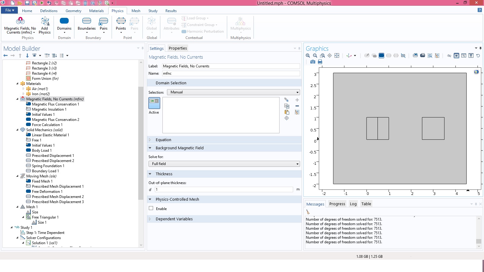

I'm doing a magnetic-structural coupling model. Thanks for your early comment. I've built a model with three physics,
1. Magnetic fiels no current model
2. Solid-mechanics model
3. Moving mesh model
I wonder if moving mesh is the ALE you mentioned before.
I can run either magnetic model or solid mechanics model. Yet when I tried to couple them together, the coupling model was not right. I just used the output force of magnetic model as the input load of solid mechanics model. For example, I inserted 'mfnc.Forcex_rod' into the body force of solid mechanics model as an input load. 'mfnc.Forcex_rod' is the force I got from the magnetic model. I dould see the results before coupling. I thought the models were not coupled at all.
Another issue was about 'continuation sweep' setting. When chose the setting and tried to set sweep type as specific combination. Nothing came out under the 'continuation parameter'. I thought I might miss certain steps before this. Yet I'm not sure it's the meshing problem or other issues.
Thanks a lot.

Dan,
There are multiple issues in your “permanent_magnet.mph” setup.
Some (not all) issues are listed below.
Solid Mechanics:
- Air domain should not be included
- Body load should be applied to the solid part which is moving (not to all domains)
- Replace Fixed Constraint by appropriate constraints along symmetry planes
- Prescribed Displacement node is not needed since movement of the solid body is governed by Body Load
Moving Mesh:
- Free Deformation should include only domain where is deformed, i.e. air domain
- Symmetry constraints are needed for two symmetry planes. These constraints are imposed by Prescribed Mesh Displacement Nodes
-There is no coupling between Mowing Mesh and Solid Mechanics nodes
Attached is working mph file of your model for the case when magnet is fixed and rod is moving. This is not an attempt to solve your specific problem but to show general setup steps for Magnetic/Solid/Moving Mesh coupling.
Note, that you can replace Solid Mechanics node by ODE and DAE Interface if you are not interested in deformation of moving solid – see example “Magnet Falling through Copper Tube” from Comsol Model Library.
Sergei
Dan, There are multiple issues in your “permanent_magnet.mph” setup. Some (not all) issues are listed below. Solid Mechanics: - Air domain should not be included - Body load should be applied to the solid part which is moving (not to all domains) - Replace Fixed Constraint by appropriate constraints along symmetry planes - Prescribed Displacement node is not needed since movement of the solid body is governed by Body Load Moving Mesh: - Free Deformation should include only domain where is deformed, i.e. air domain - Symmetry constraints are needed for two symmetry planes. These constraints are imposed by Prescribed Mesh Displacement Nodes -There is no coupling between Mowing Mesh and Solid Mechanics nodes Attached is working mph file of your model for the case when magnet is fixed and rod is moving. This is not an attempt to solve your specific problem but to show general setup steps for Magnetic/Solid/Moving Mesh coupling. Note, that you can replace Solid Mechanics node by ODE and DAE Interface if you are not interested in deformation of moving solid – see example “Magnet Falling through Copper Tube” from Comsol Model Library. Regards, Sergei

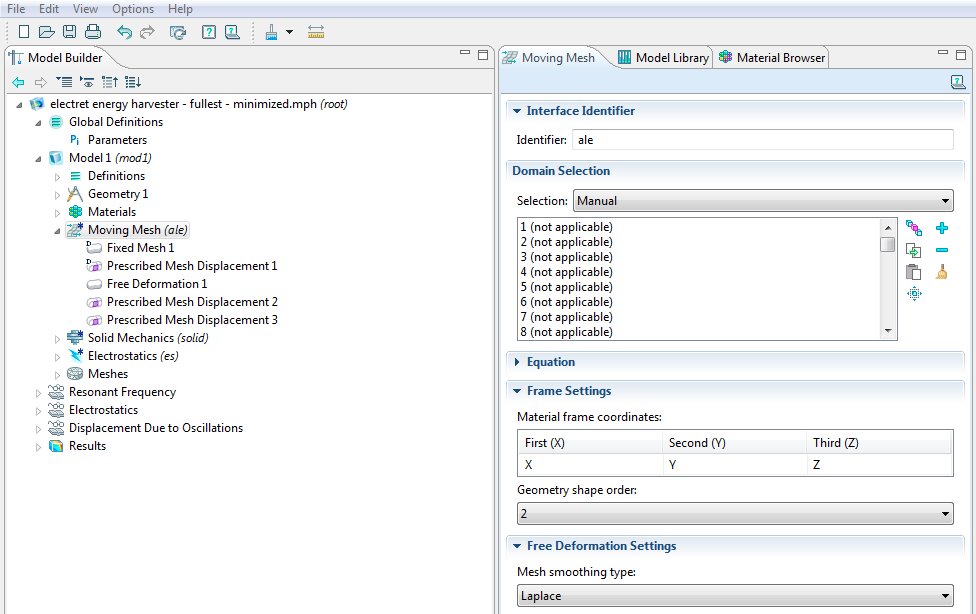

Posted: 1 decade ago 2013/03/24 5:03 GMT-4
another issue I have been told: set the moveing mesh ALE physics first, before the structural, as node order / precedence has also some importance. Solid and its frames, and ALE do interfer.
As clearly stated in the reply above, we need to analyse our models first, in detail: identify clearly the links, see which dependent variables are solved where and identify how to link them.
Multiphyiscs, is somewhat more complex than what one could first think, but once used to it, it becomes real fun ;)
When I set my moving mesh ALE node before the solid mechanics node, all the domains I had chosen in the moving mesh become not applicable. Please see attached screenshot.
Thanks,
[QUOTE] Hi another issue I have been told: set the moveing mesh ALE physics first, before the structural, as node order / precedence has also some importance. Solid and its frames, and ALE do interfer. As clearly stated in the reply above, we need to analyse our models first, in detail: identify clearly the links, see which dependent variables are solved where and identify how to link them. Multiphyiscs, is somewhat more complex than what one could first think, but once used to it, it becomes real fun ;) -- Good luck Ivar [/QUOTE] Hi, When I set my moving mesh ALE node before the solid mechanics node, all the domains I had chosen in the moving mesh become not applicable. Please see attached screenshot. Thanks, Jeff
Posted: 1 decade ago 2013/03/24 14:50 GMT-4
that is exactly it, Solid has its own frame system so this overides ALE, ALE is for air (which is no solid) domain that is deformed by the solid deformation (check the model library examples)
Hi that is exactly it, Solid has its own frame system so this overides ALE, ALE is for air (which is no solid) domain that is deformed by the solid deformation (check the model library examples) -- Good luck Ivar
