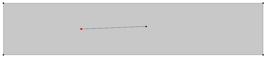

I am studying pipe flow, currently in 2D.
I have placed a rigid interior wall, making a certain angle with the direction of flow, inside the pipe. Ideally, I would like it to rotate 'freely' around its first edge (see picture, the red point would be the axis). As of now, I am only using the Laminar Flow module.
By freely, I mean subjected to the flow. How can I achieve this?

I'm not sure COMSOL 4.2a allows you to simulate a thin wall like that (may be, perhaps someone else has managed) because for a FSi you need from, my knowledge, a domain (a surface in 2D). But you can make it thin and I would end it with two half circular ends to allow a better meshing and fluid separation (avoid right angle corners in CFD but also ACDC ...). Then to give a rotation axis, one way is to make a hollow cylinder and apply a roller structural BC or apply a weak equation to enforce a rotation

Thank you for your reply
Yes, maybe that will have to do (and thank you for the tips). I have used fillet (the circular ends, right?) and it bends the obstacle nicely. However, I want the obstacle to be rigid, so I guess I'd have to mess with the Young modulus. And add a constraint to a point?
I found this: www.comsol.com/community/forums/general/thread/15286/#p41764
Can someone point me in the right direction? My obstacle's movement will also come from an external ODE, I "just" don't know how to move the obstacle mid simulation.

you could try with the Rigid Connector on your structural domain, that will enforce it to be "rigid"
