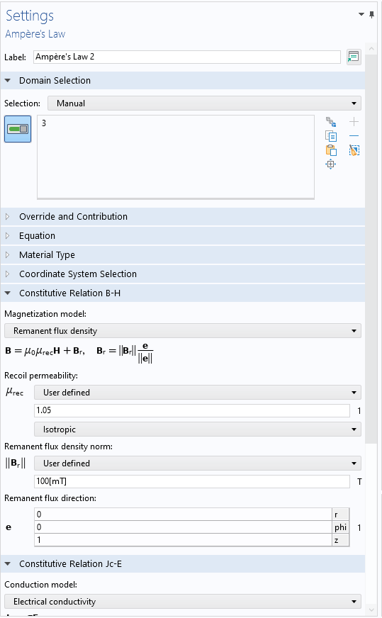

When creating a permanent magnet using an Ampere's Law node (in Magnetic Fields), I have the option to set the "recoil permeability" . What is recoil permeability?
From the equation, it looks similar, perhaps, to a relative permeability. But if that were the case, why not just call it "relative?" How do I figure out the value of for the real-life neodymium magnet I am modeling in COMSOL?
