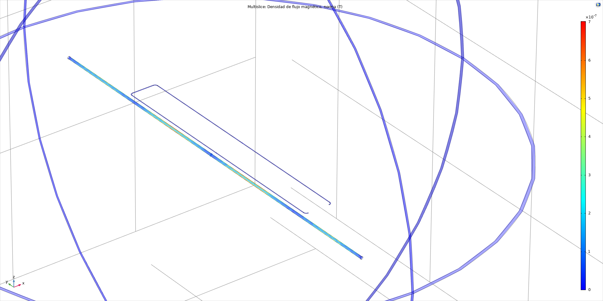

I have an issue with a 3D model. I am trying to show the magnetic field created by a DC current (10 amps) trough a straight wire, I have chosen magnetic fields and electrics (steady), and the result after calculate do not show this magnetic field, just a very low value... Even when rise the current (till 100 amps), it does not change... I have done it in 3.5 version in 2D and works very well. I do not know what I am missing.

sure, you can find it attached the image with the results (magnetic flux density)
By model I am referring to the .mph file, not an image from post processing. I suggest you post the file with the .mph extension.
