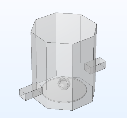

I following the tutorial microwave oven from comsol. I try to built the octagonal shape for microwave oven. when I simulate, the heat generated in the potato doesn't change. Even though I have followed all the steps in the microwave oven tutorial, the only difference is the shape of the microwave oven. what is the problem? Please guide me with necessary step. Thank you very much.

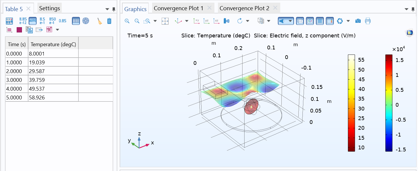

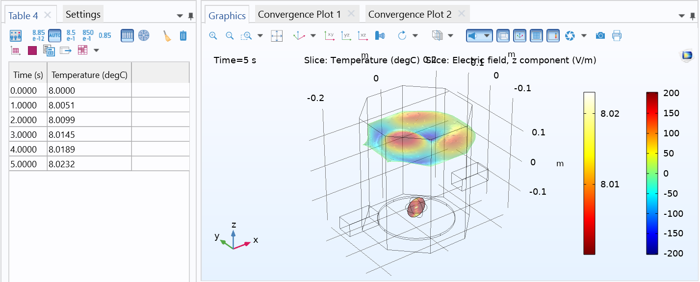

I'm sorry about that, maybe what I'm asking isn't clear. In rectangular microwave oven the heat of potato can increase significantly. But, in octagonal microwave oven the heat of potato can not increase significantly. The simulation time is the same. I don't know what step i missed, because I following the tutorial microwave oven from comsol. Thank you very much.

Well, based only on the pictures you provided, you seem to be generating stronger fields (at least for the snapshot of the z-component of E that you plotted; a normE plot would have been more informative) in the vicinity of the potato, for the case of the rectangular oven. Stronger fields in/on the potato would be consistent with more rapid heating. What reason, if any, did you have to suppose that using an octagonal cross section (along with any other geometric or other changes that you might have made in your model, but which one can't tell from the pictures), would be beneficial? Do you have some literature, perhaps, that suggests octagonal-cylindrical ovens should work better? And your feed system appears to have changed also.
