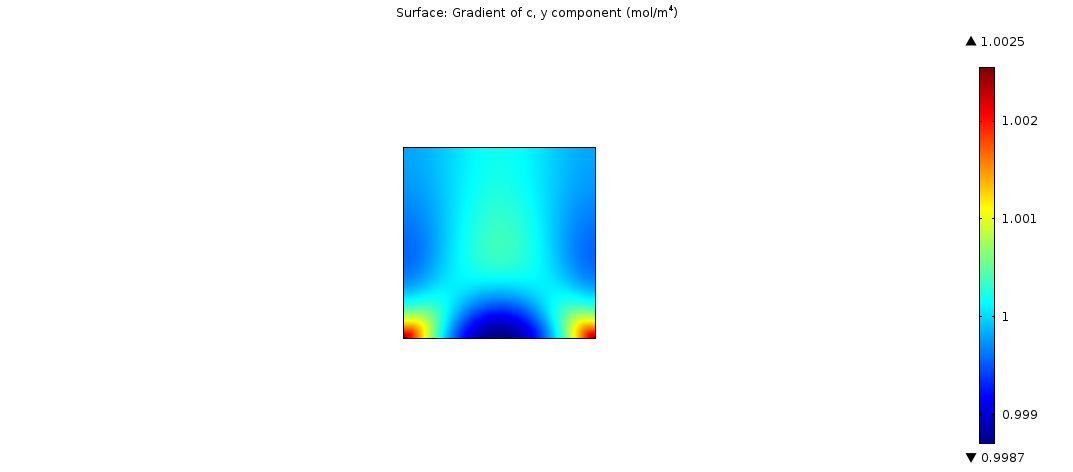

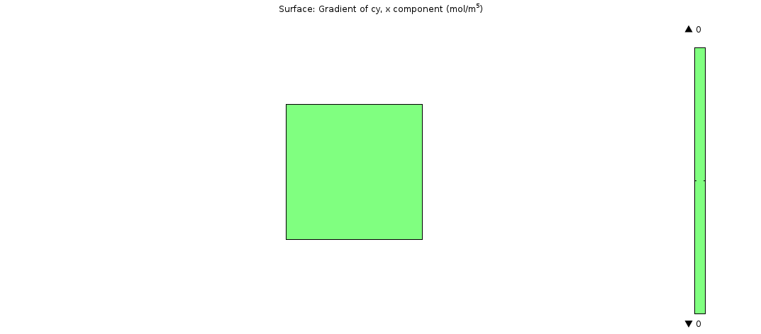

I am having problems with using higher order spacial derivatives.
For example, I have the first order y derivative of a function c : cy.
It is clear from the attached picture that the second order derivative of cyx is not zero and yet when I plot cyx I get exactly zero. I don't understand what is wrong.
