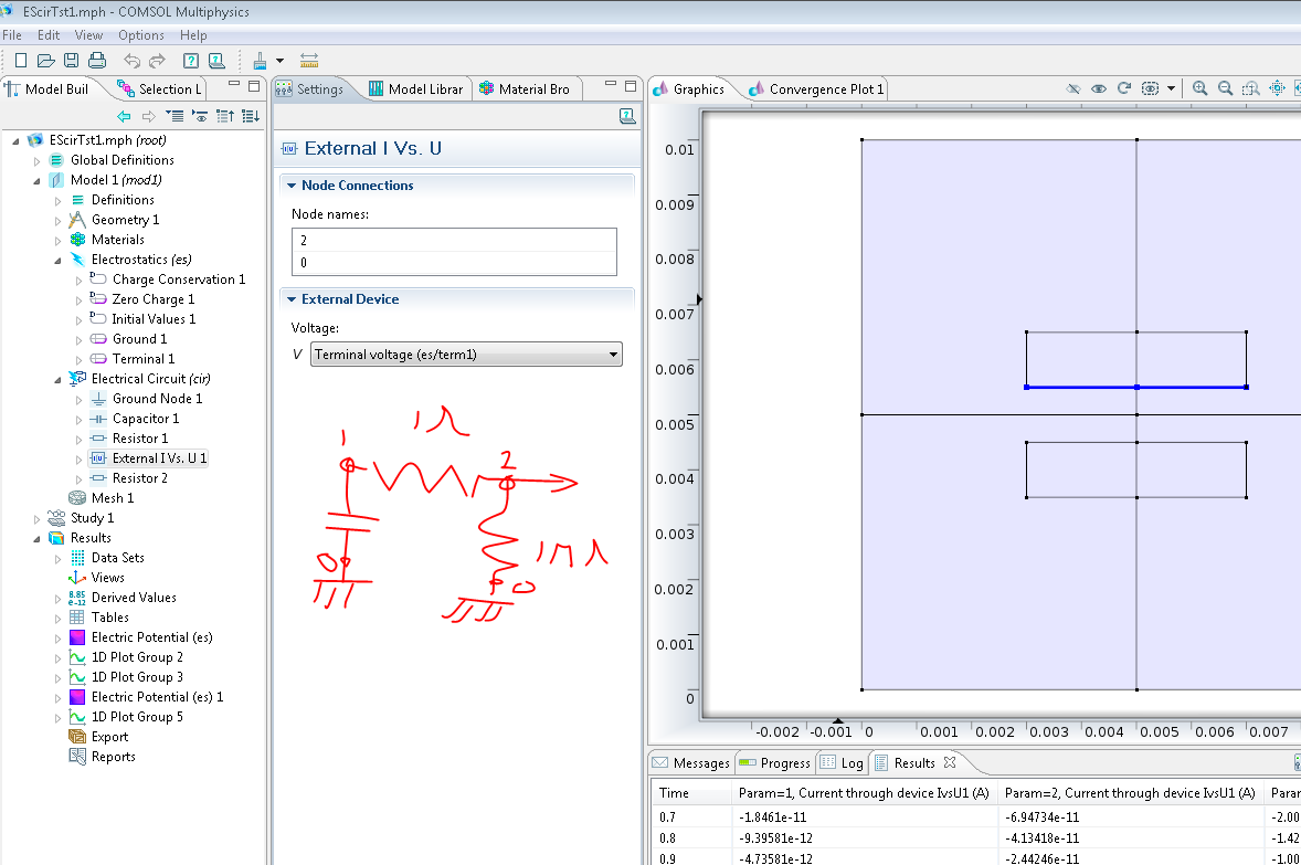

I need to make a capacitive divider, the first capacity is modeled by the electrostatic model and the secondary capacity is modeled by the CIR model electric, for what I need to make an electrostatic coupling between the model and the CIR model .
how the coupling between the electrostatic model and the CIR model?

Here is a simple example hope it helps (in 4.2a I do not have any earlier version up running)
Hi Here is a simple example hope it helps (in 4.2a I do not have any earlier version up running) -- Good luck Ivar
