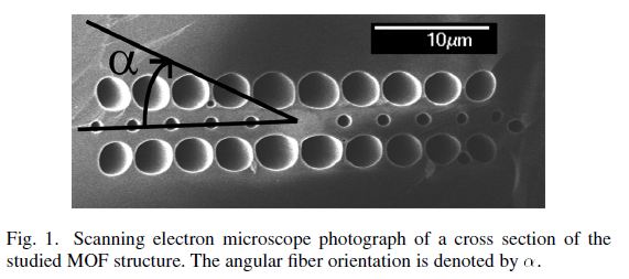

I am doing simulation of the NEMO fiber( I have attached the SEM image from Geernert et.al. IEEE photonics letters,20, 8, 2008) with dooped core( defect in the centre).
I have put a rectangular PML around the airholes so as to enclose the microstructure,
If I give assign the PML refractive index the cladding refractive index I do not get fundamental mode at the expected mode index but if I do the same with air refractive index I get the results.
I do not know exactly as to why the air refractive index for PML works even though its inside the cladding. Can someone clear my doubt?
Akhilesh
Thanks to both Ivar and Felipe, I am doing simulation of the NEMO fiber( I have attached the SEM image from Geernert et.al. IEEE photonics letters,20, 8, 2008) with dooped core( defect in the centre). I have put a rectangular PML around the airholes so as to enclose the microstructure, If I give assign the PML refractive index the cladding refractive index I do not get fundamental mode at the expected mode index but if I do the same with air refractive index I get the results. I do not know exactly as to why the air refractive index for PML works even though its inside the cladding. Can someone clear my doubt? Akhilesh
Posted: 1 decade ago 2012/05/28 3:04 GMT-4
I understand that as the effect of the glass air interface has it's importance for the overall EM field. I would anyhow better trust a model that includes the overall environment, hence air, and use the infinite or PML layer sufficiently far away from the high index structure so that any evanescent wave has mainly died out before one enter the PML layer
Hi I understand that as the effect of the glass air interface has it's importance for the overall EM field. I would anyhow better trust a model that includes the overall environment, hence air, and use the infinite or PML layer sufficiently far away from the high index structure so that any evanescent wave has mainly died out before one enter the PML layer -- Good luck Ivar
Posted: 1 decade ago 2012/05/30 3:41 GMT-4
The purpose of PML is to reduce the computational domain and if we place it far away does'nt it loose its purpose?
Posted: 1 decade ago 2012/05/30 8:54 GMT-4
Indeed so it's our definition of "far" that is not in line.
For me it means a few wavelength as a minimum, just to be sure that whatever is reflected (even if it should not be) is not directly lined up to give too high interferences, so in now way even cm's, for a standard fibre model
Hi Indeed so it's our definition of "far" that is not in line. For me it means a few wavelength as a minimum, just to be sure that whatever is reflected (even if it should not be) is not directly lined up to give too high interferences, so in now way even cm's, for a standard fibre model -- Good luck Ivar
