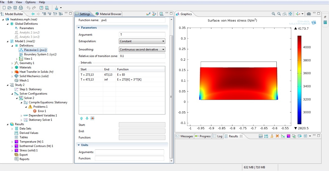

I've tryed it, but there are some errors still. I've attached a jpg file to show, how I've done it. the syntax is definitly wrong, but I dont rly know how to do it right. I would be grateful for a little hint!
Thx in Advance!
I've tryed it, but there are some errors still. I've attached a jpg file to show, how I've done it. the syntax is definitly wrong, but I dont rly know how to do it right. I would be grateful for a little hint! Thx in Advance!

I believe its the T= and E= that are not accepted
check the doc and the model library for a model having one of these functions
normally its the min value (number or parameter equation to calculate it, then the same for the max value and finally the equation, including the T, if T is the argument, but no = the response comes in the function name so you call it from any GUI field entry
pw1(T[1/K])
Hi I believe its the T= and E= that are not accepted check the doc and the model library for a model having one of these functions normally its the min value (number or parameter equation to calculate it, then the same for the max value and finally the equation, including the T, if T is the argument, but no = the response comes in the function name so you call it from any GUI field entry pw1(T[1/K]) -- Good luck Ivar

Thank you Ivar, that really helped!
