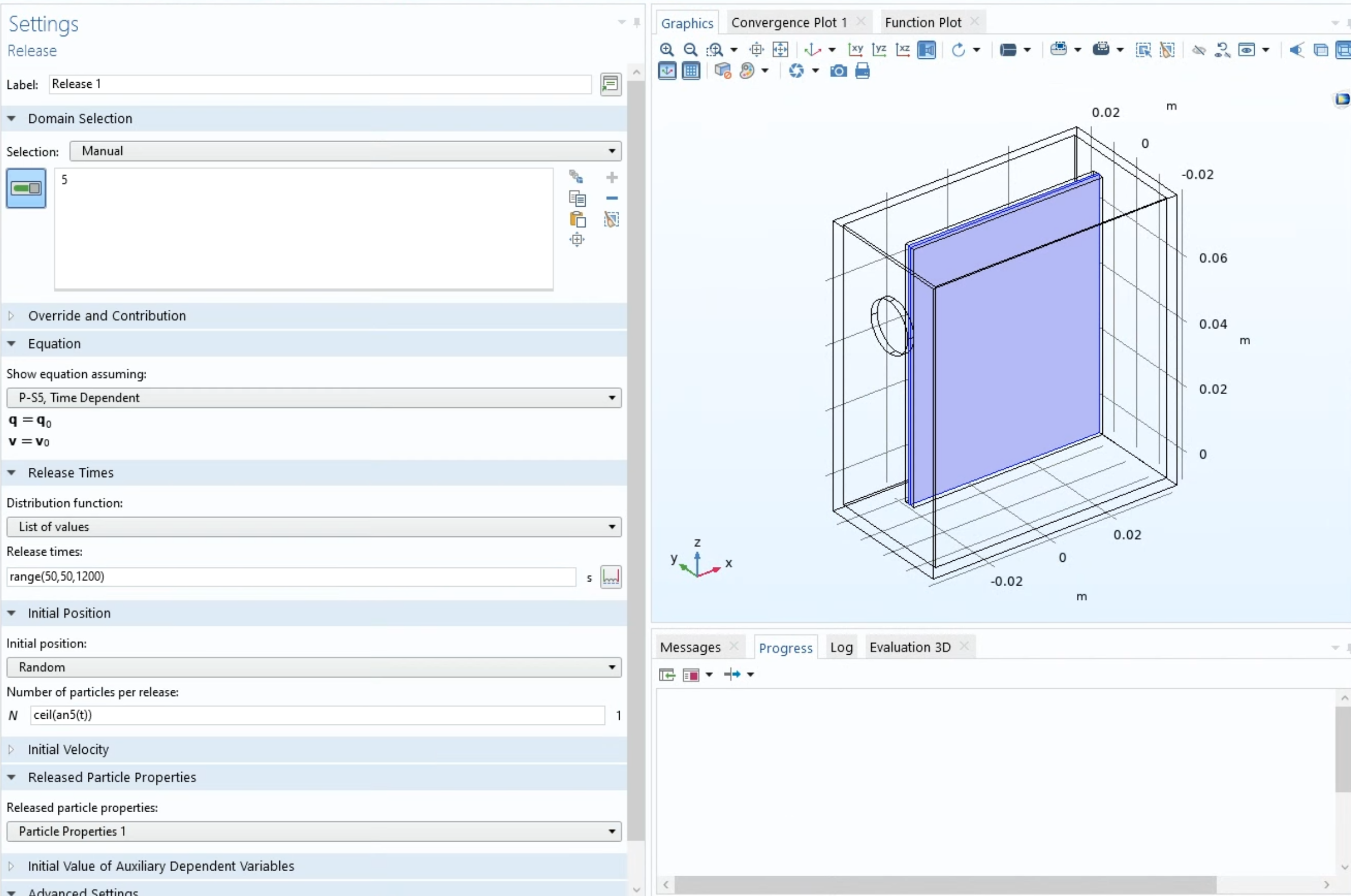

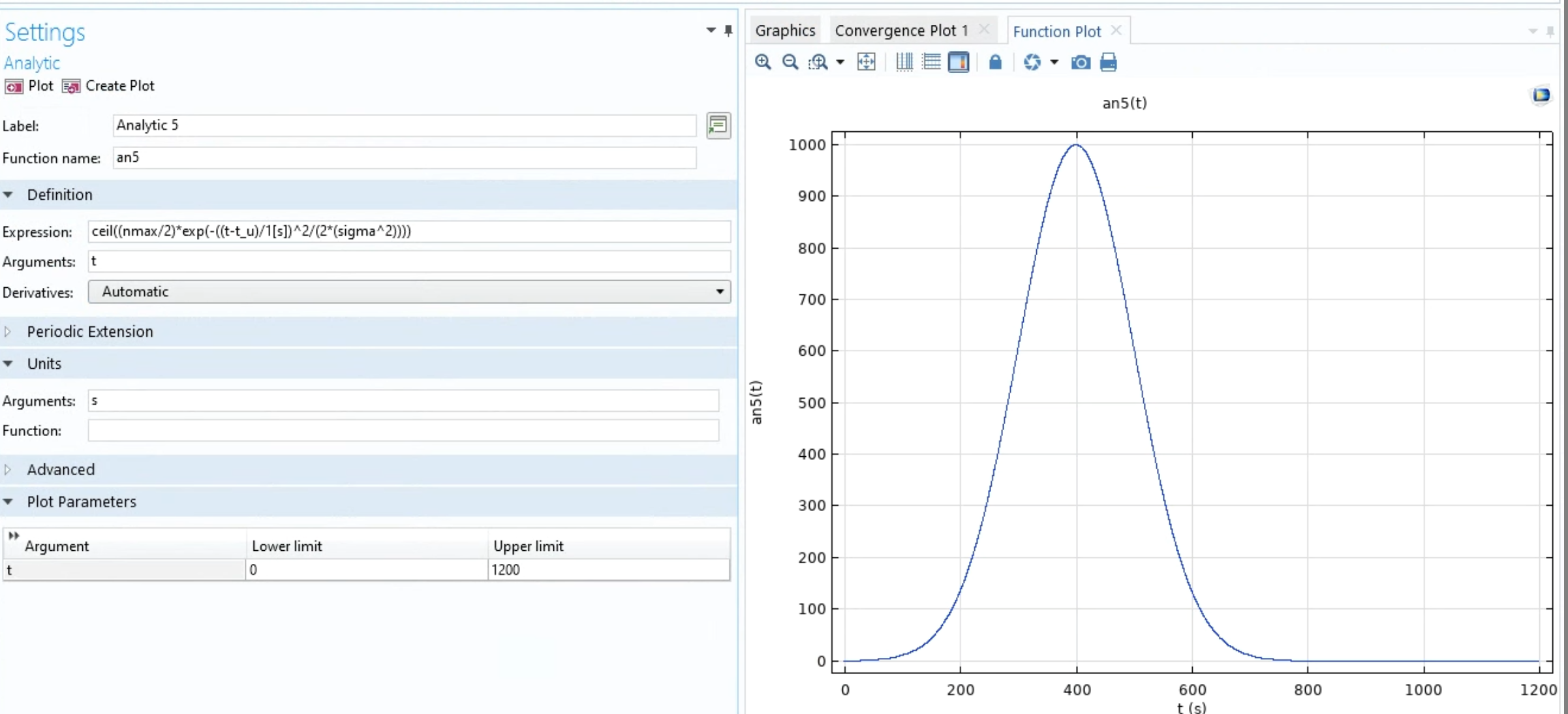

I'm trying to simulate a condition at which particles are released at multiple timestep, wherein on each timestep the number of particles released follows a defined distribution (see attached photo).

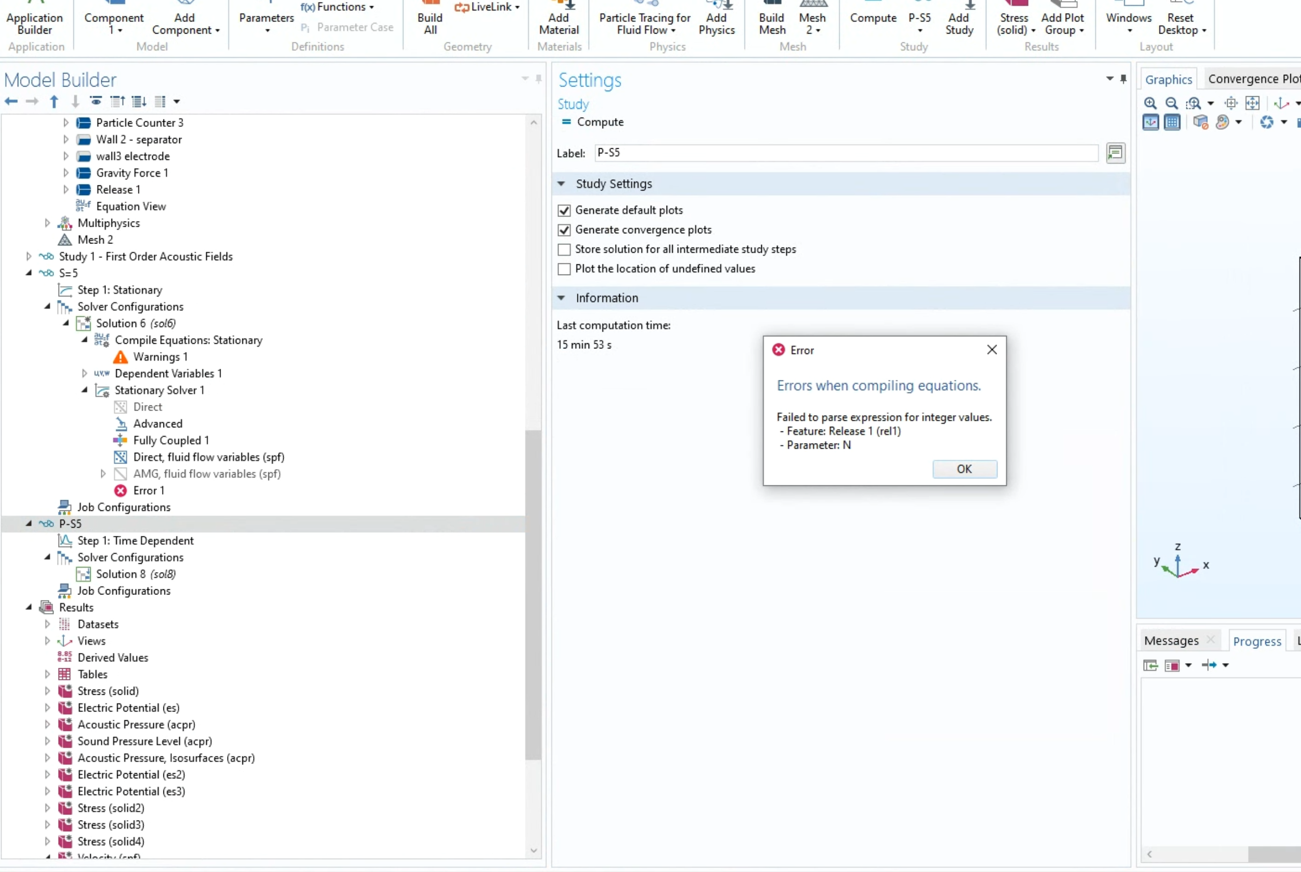

In doing so, I always encounter an error "Error when compiling equations. Failed to parse expression for integer values. -Feature: Release 1(rel1) - Parameter:N" whenever i plug in the current time on the equation. I tried to round-off the value of using ceil() function however it doesn't work and the error persist.

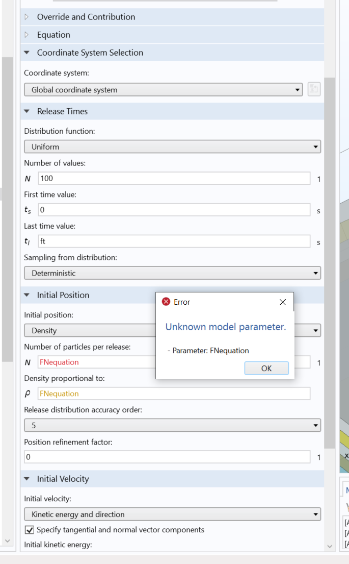

It semms to be a bug in COMSOL! I need to define an inlet with varying number per release in my project as well. I need both the number and density of electrons per released to be a function of the electric field at the surface of the feature from which I want the electrons to be released. So, just like you, I am defining a variable, FNequation in my case, and put it in "Number of particle per release:" and "Density proportional to:" boxes, which are just after each other in the inlet seting menue as you can see from the attached picture. The surprise for me is that one of these boxes recognised my variable, FNequation, but the other one does not. The density box has no problem with the variable but the box for number of particles per release is returning this error: "Unknown model parameter. -Parameter: FNequation". Similar to your case, if I put a constant value in that box the error no longer exist. I have also tried ceil(FNequation) and floor(FNequation) to make sure that I am feeding the box with a integer value but it does not remove the error.
If you have got any solution to your problem please let me know too.

Hi, this is not a bug but the intended behavior in the current version of COMSOL. When a particle tracing model has multiple release times, the number of particles released is required to be the same for all release times. So the "Number of particles per release" may not be an expression that depends on the time or solution variables, even if that expression should return an integer value. It can only depend on global parameters.
