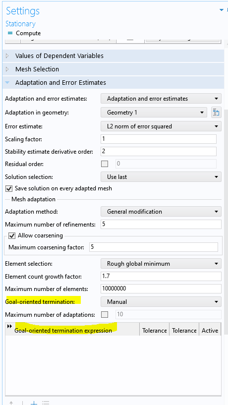

I have noticed a function called "Goal-oriented termination" under Stationary Settings/Adaptation and Error Estimates, which seems like it can evaluate the error of specific expression. I would like to evaluate calculated variables, for example, electromagnetic force that is calculated by "Force Calculation" with force name "Mag", but it seems like after I typed in the expression "mef.forcez_Mag", it showed "unknown variables". I have even tried one of the default variables like "mef.normB" but still, showed "unknown variables". The only variables that work for me are the global parameters that I have defined, which are pointless for error evaluation since they are all constants. Is there a guide/blog that includes an instruction of this function? I have searched for relevant information, but maybe because this is a new function, there is barely any discussion about it. Any help would be appreciated!
Thanks, Zhancheng Yao
