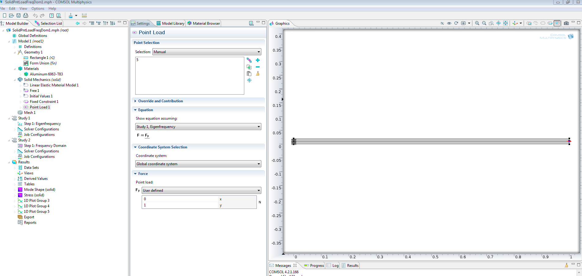

how to create a point that oscillates (up and down) with a determined frequency?
(so that it will generate a wave propagating along a plate)
Btw, I'm using acoustic-structure interaction module, is the correct one to use for this application?
(and I'm using 2D, square)
here is an example its for 4.2a
But normally one should not use "point" loads as these leads to "singularities", rather boundary loads
For a plate you could also use a Pressure boundary load, from tha acoustic solution

well I do not have any earlier version than 4.2a up running, but here is a screen view, the point load is not the best way, the better is a boundary load on the tip edge, but in this case you get the same results

by the way, how to put the point source oscilating with a specific frequency?
If you check the forum this has been discussed several times:
are you interested in the transients or in a steady state value ?
1) for transient choose the time series solver, add the force as F0*sin(2*pi*freq*t) and solve, then decide if you want to include the inertial terms or only the quasi static ones, usea fine time step to resolve your sinus periode, and set the Time Stepping tab in the lower level solver node to "intermediate" as "free" will mostly skip over your oscillations
2) for a harmonic development (if applicable to your physics) then choose the Frequency Domain solver, define the frequency or frequency range in the solver settings, and the force amplitude F0 as the point or better boundary load. You miht add a phase info either as a phasor F0*exp(i*phase_in_rad) or by a explicit phase field, or subnode, if there

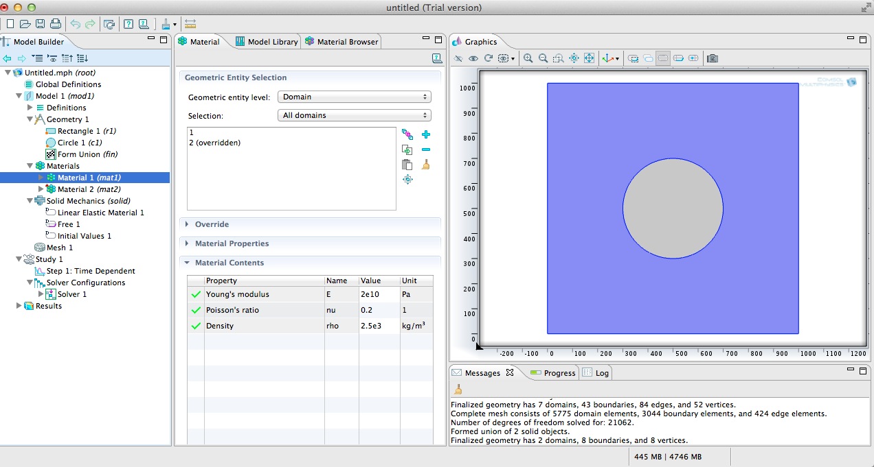

Sorry to bother you, but i find your model almost fits my problem. "Scientists and engineers that seek to understand elastic wave propagation in geological structures typically consider the generic problem of a seismic wave that is generated at a source, propagates through a media, and is measured at a receiver." describes my problem perfectly. In my case, the media contains two different isotropic material. What i want is the waveforms at different receivers. I am wondering if you can help me with this. I assume there is a boundary load on the top boundary of material 1. Please see my attached geometry file. Thank you so much.
