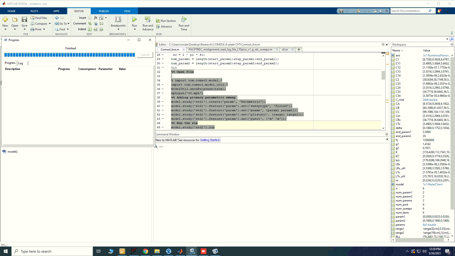

ModelUtil.showProgress(true) belongs to a COMCOL library that needs to be imported into Matlab. This is done through "import com.comsol.model.util.*". Note that this is also done in the MPH-file. If you open the m-file of your mph-file, it is your second line. For some strange reason, Matlab likes to have the libraries before openning the mph-file. I did so and it worked! Now I see the progress bar without any error throughout the simulation. Here is the final code:
%% Importing library import com.comsol.model.util.* ModelUtil.showProgress(true);
%% Openning file mphopen('v0.mph')
%% Adding primary parametric sweep model.study('std1').create('param', 'Parametric'); model.study('std1').feature('param').set('sweeptype', 'filled'); model.study('std1').feature('param').set('pname', {param1 param2}); model.study('std1').feature('param').set('plistarr', {range1 range2}); model.study('std1').feature('param').set('punit', {'m' 'm'});
%% Run the sim model.study('std1').run
The progress window does not pop out as it is a subcategory of the DOS command window that creates the livelink. Windows however notifies you where you can find it. This is what has worked for me and hope works for you too. I wish the COMSOL sopport team spent more time on explaining how these prompts work together.

Saving the model as an M-file as a way to learn about the COMSOL API syntax is the recommended way of learning about how things work since that is the fastest approach.
Setting up everything or most of your model using the COMSOL GUI is also the recommended way of working with Comsol model since MPH-files tend to load faster than running the entire script that recreates the model fram scratch.
The COMSOL API is based on Java, which is easily accessible in Matlab. You use the import statement to make it possible for Matlab to find the libraries it needs. If you don't like to use import statement you can also resort to using statements like this one:
com.comsol.model.util.ModelUtil.showProgress(true)
Note that there is no difference in working with a model using LiveLink for Matlab compared to working with the model using the COMSOL GUI. At any time you can use either environment to interact with your model and e.g. redefine any parts of your model. You can even use the two environments simultaneously. Use this command to see how:
help mphlaunch
