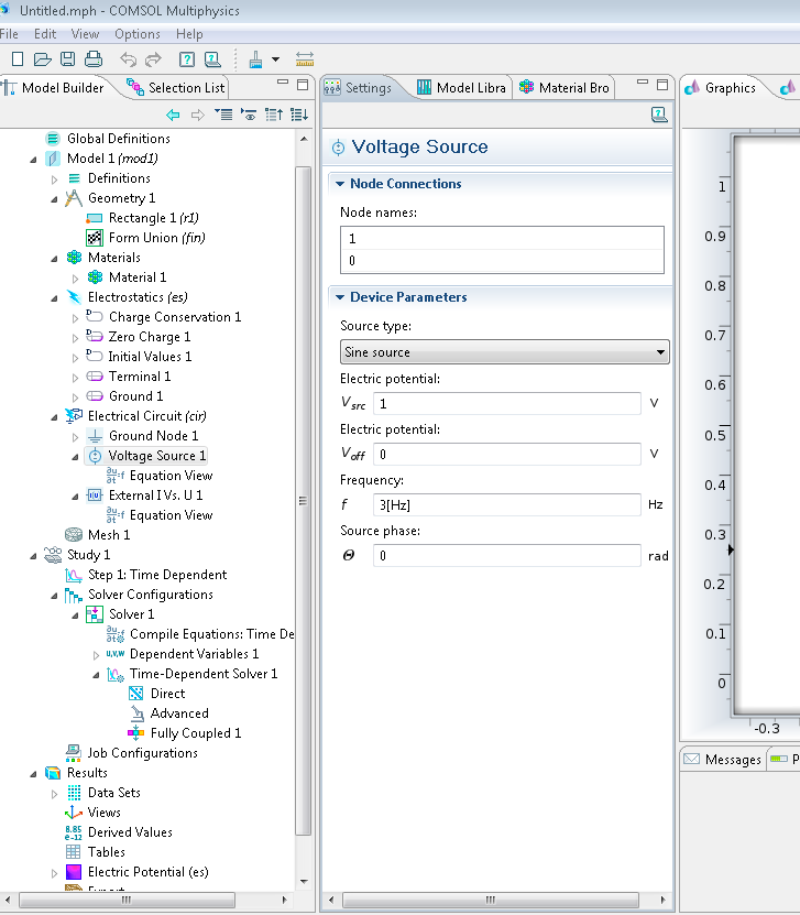

coupling electrostatic model and model electric circuit
is that one can apply a sinusoidal voltage of the CIR model on a terminal of the electrostatic model?

you cannot link ES to an CIR AC source, but you can link it to a CIR Sinus source, the AC source are for Frequency domain solvers and ES is not set up for harmonic solving ES=Electro-Static and not Dynamic ;)
But why use a CIR ? you can as well define a V0*sin(2*pi*Freq*t[1/s]) as terminal or Electric Potential within ES
