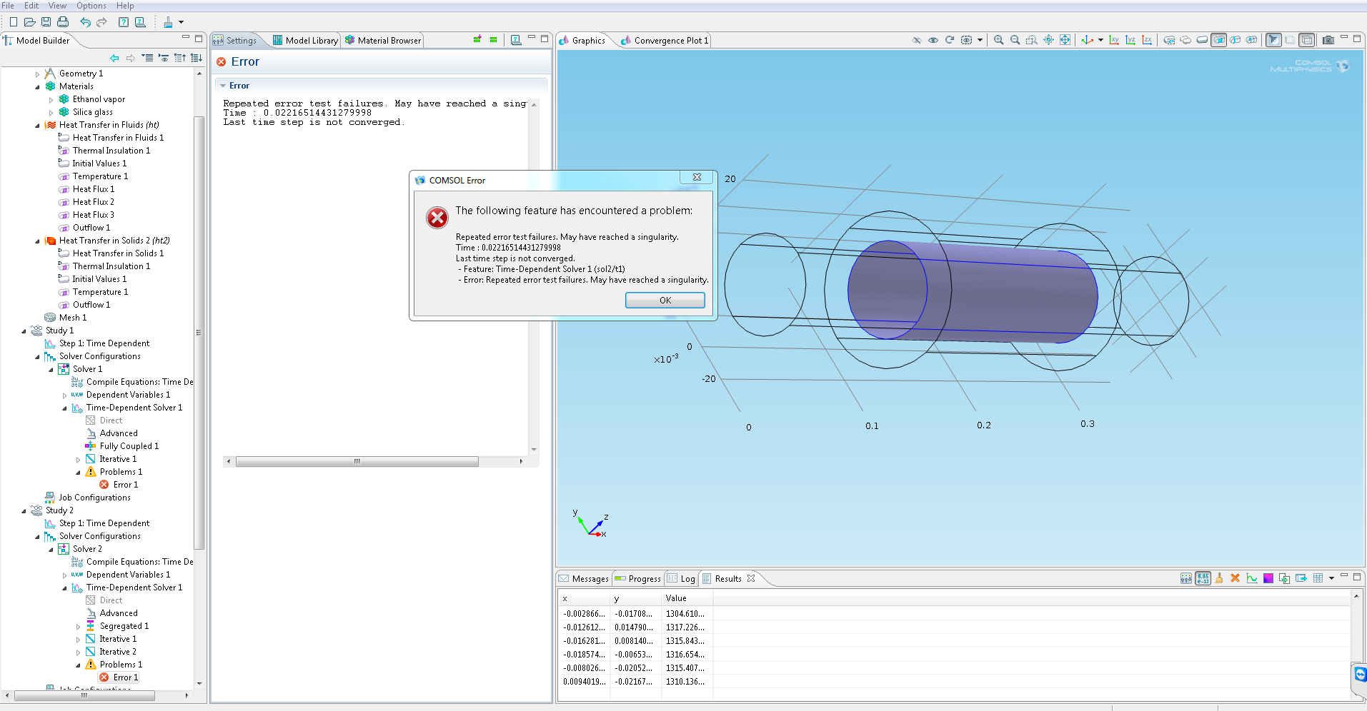

Posted: 1 decade ago 2012/06/07 17:39 JST
Hi dear Ivar,
You know it's a pleasure to always exchange with you "Simulaters" about problems encourted.
Again I come over to you for this problem i don't understand...time step error.
Please need your help
A. Fopah Lele
Hi dear Ivar, You know it's a pleasure to always exchange with you "Simulaters" about problems encourted. Again I come over to you for this problem i don't understand...time step error. Please need your help -- A. Fopah Lele
Posted: 1 decade ago 2012/06/07 17:53 JST
do NOT add a second physics HT2, but add a "Domain Heat Transfer in Solid" physics node in the first HT
Than will make your life far easier ;)
Hi do NOT add a second physics HT2, but add a "Domain Heat Transfer in Solid" physics node in the first HT Than will make your life far easier ;) -- Good luck Ivar
