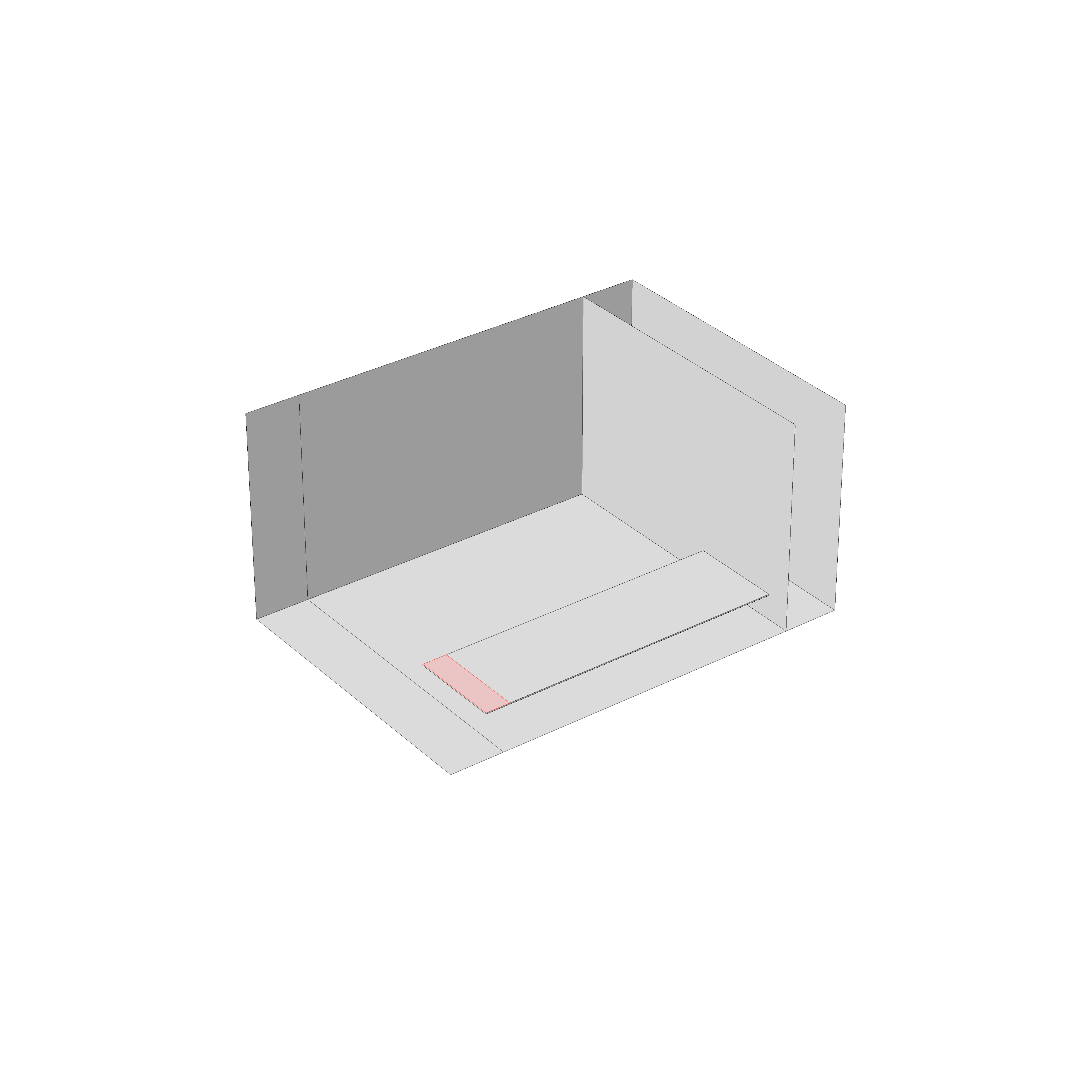

I'm trying to adept this example to a 3D problem. I have drawn a simple beam in 3D and I have the stationary simulation working fine. I apply a potential and compute the deflection. It takes 28 seconds, it's a small mesh.
To derive an estimate for the pull-in potentional I add a global equation solving (intop1(z)-zset)/zset
I pick the centre point of the beam for intop1.
In the stationary study I add the continuation parameter zset with range(1600[nm],400[nm],2400[nm])
I change the solver to fully coupled.
The simulation however does not converge, it is stuck at step 1.
Does anyone know how to solve this?

It is as simple as that, a fixed-fixed beam in air over an electrode, the electrode is underneath all of the beam.
I couldn't draw it any simpler.
The mesh is 1420 elements, it's a bit like the cantilever example: www.comsol.com/showroom/gallery/444/
The air gap is actually 3500 nm
I can reduce the mesh to 520 elements but it still doesn't converge.
I can change the range to something that isn' much of a deflection: range(3000[nm],200[nm],3400[nm])
but no joy.
Following is from the log, I canceled the operation after 1 and a half minute. maybe it helps:

It is as simple as that, a fixed-fixed beam in air over an electrode, the electrode is underneath all of the beam. I couldn't draw it any simpler. The mesh is 1420 elements, it's a bit like the cantilever example: http://www.comsol.com/showroom/gallery/444/ The air gap is actually 3500 nm I can reduce the mesh to 520 elements but it still doesn't converge. I can change the range to something that isn' much of a deflection: range(3000[nm],200[nm],3400[nm]) but no joy. Following is from the log, I canceled the operation after 1 and a half minute. maybe it helps: ========================= Stationary Solver 1 in Solver 1 started at 12-Sep-2012 12:16:44. Parametric solver Nonlinear solver Number of degrees of freedom solved for: 23002. Parameter zset = 3e-006. Nonsymmetric matrix found. Scales for dependent variables: mod1.V: 0.0001 mod1.u: 1.3e-015 mod1.xyz: 1.3e-010 mod1.ODE1: 2.7e-011 Inconsistent pointwise unidirectional constraints found. 99 constraints are merged/removed. Iter ErrEst Damping Stepsize #Res #Jac #Sol LinIt LinErr LinRes Canceled Stationary Solver 1 in Solver 1: Solution time: 93 s. (1 minute, 33 seconds)

I'm trying to find the pull in voltage for this device, but I can't seem to find my mistake. I have the integration method set to find the coordinate of the center of the bottom boundary of the top diaphragm, swept mesh, and fully coupled solver with a sweep over zset. Can you take a look at this and see what can be fixed?
Thanks
Hi, I'm trying to find the pull in voltage for this device, but I can't seem to find my mistake. I have the integration method set to find the coordinate of the center of the bottom boundary of the top diaphragm, swept mesh, and fully coupled solver with a sweep over zset. Can you take a look at this and see what can be fixed? Thanks
