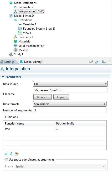

I then have the following two lines:
model.func('int1').setIndex('funcs', 'int2', 0, 0);
model.study('std1').run;
To know what the int2 is doing, I attach a screenshot.
I guess that implementing directly from MATLAB array should also be simple but I have not had time to do it.

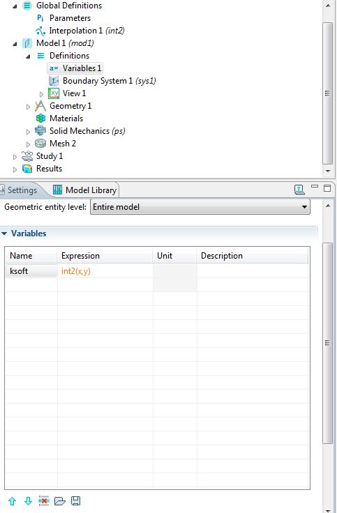

Would I complete the task simply by setting my material parameter to 'ksoft', using your example?
Cheers,
Brian
Suresh,
I'm not quite sure what your last 2 lines accomplish. I managed to get COMSOL to read and interpolate the .txt file by setting up int1 and the variable by hand in COMSOL, but I need to be able to set these through MATLAB (since it's going to iterate in a MATLAB loop). Any thoughts?
