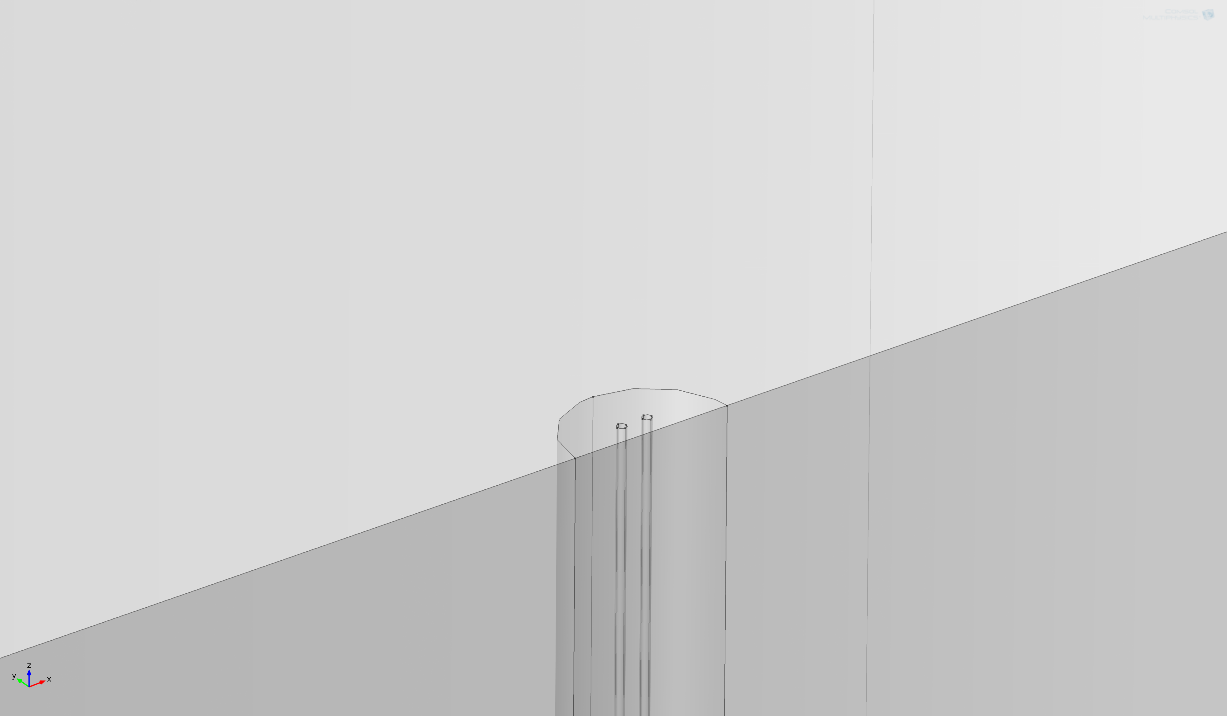

I created a 3D borehole heat exchanger model. It includes 'Heat Transfer in Solids' and 'Thin Conductive Shell' nodes. After getting the velocity profile of the fluid using stationary analysis, I solve the working of the heat exchanger using time-dependent analysis by applying an added temperature difference to the inlet (inlet = outlet + delta_T(t)).
So far, this model works. However, I also have experimental field data for the inlet and outlet temperature measurements and the model output differs from the field data. I am looking for a way to use the optimization module to alter the thermal conductivity of the soil to match the experimental data with the model output.
I wonder if it is possible. If yes, could you please guide me at least where to start? I tried to use the optimization module by adding control variable field, pointwise inequality constraint and least squares objective (time+value columns) but I couldn't make it to work.
The inside of the pipes in my model are empty, they are modeled by thin conductive shell elements and thus, my inlet/outlet are defined as edges. I also included a screenshot of my geometry.
Thanks in advance.
Tolga
