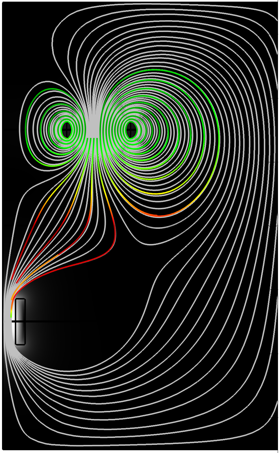

Sorry if I have been slightly unclear. I have attached a image of the same setup using the post-processing particle tracer instead. I've messed around with the colours slighty, the black to white background indicates B-field magnitude, the grey lines are 'streamlines' for the B-field and the coloured tracks are the particle tracing, green indicates high speed, red low. This is the behaviour I am expecting from the CPT module but am not getting; it is not taking the B-field into account. The particles released from the upper surface should roughly follow the field lines - this would be more accurate a statement if the E-field were turned off.
The Lorentz force due to such a large magnetic field should cause the particle to follow the field lines whilst executing a helical orbit. The component of velocity along the field line, as you said, gives no force. The component of velocity perpendicular to the field line results in a force which causes the particle to orbit around the field line. In the image I have attached, the particle tracks are really small helical tracks when one zooms in.
This was news to me having never taken a plasma physics course, but apparently this is widely known - 'Magnetic confinement rests upon the property that charged particles, like those in a plasma, will travel along the lines of a magnetic field'.
I completely agree with your final sentence, however it is precisely the functionality I am asking about. The Lorentz-force is purely out of plane initially and so for all time as far as the CPT module is concerned. I need the CPT module to take this out-of-plane force into account. I believe the 'Include out of plane degrees of freedom' check-box in the CPT settings should allow it to correctly account for this but it throws errors when I try this. If the somewhat 'simpler' post-processing particle tracer can include the out-of-plane forces, as shown by the attached image, I assume the more complicated CPT module also can.

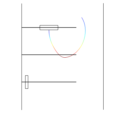

Starting with your original model and doing exactly what you did (i.e. "Include out-of-plane degrees of freedom" to "on", "Steps taken by solver" to "manual", "Time step" to "1e-11"), then re-running the particle tracing study, I got an error message saying "Solution cannot be updated. Clear Solution to expunge. Failed to evaluate variable Jacobian."
I then cleared the solution, re-ran both studies, and voilà, it worked, see figure attached or the modified model file. (Turns out, "File extension error" is the forum software's way of saying, "You need to activate Firefox's Flash plugin." Obviously...)
