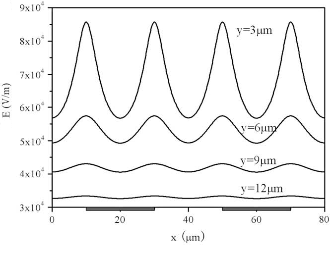

I am using AC/DC module to simulate the electric field distribution over a microelectrode when applying AC input voltage. I manged to get the total electric field distribution E (V/m) over the microelectrode, its expression is "ec.normE".
However, I have two problems:
1) How can I plot the electric field gradient ∇|E2|? Its unit is (V2/m3).
2) Can Comsol plot the electric field in such a way it shows the "dome-shaped" electrical field?
Please refer to the attachment to see an example of "dome-shaped" electrical field.
Could anyone please help me in either questions?
Your help is much appreciated.
Bashar

You want the gradient of the norm squared ? or something like (d(ec.normE^2,x), d(ec.normE^2,y), d(ec.normE^2,z))
I'm not sre it will work, but have a try (I'm not by my WS tonight ;), the gradient of the field are already there in COMSOL, the easiest to learn all the existing variables, is to enable the Equation view, and go through the lists of all variables
Hi You want the gradient of the norm squared ? or something like (d(ec.normE^2,x), d(ec.normE^2,y), d(ec.normE^2,z)) I'm not sre it will work, but have a try (I'm not by my WS tonight ;), the gradient of the field are already there in COMSOL, the easiest to learn all the existing variables, is to enable the Equation view, and go through the lists of all variables -- Good luck Ivar

Thank you very much, Ivar. You helped me!
