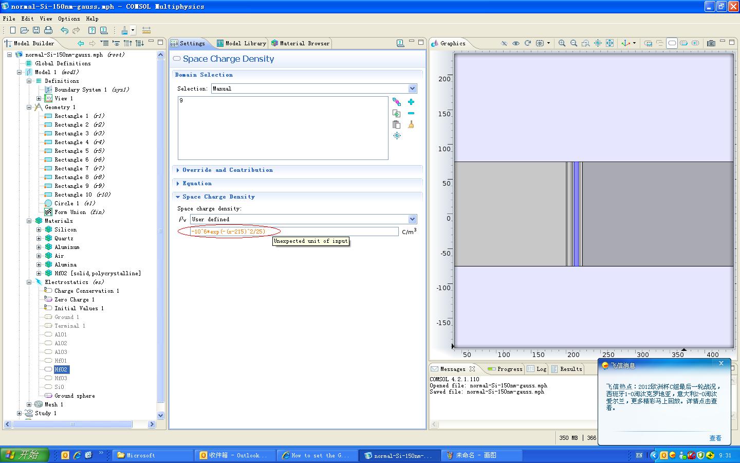

Thank you very much for your quick reply.
But I can not set the unit since the default unit of charge is C/cm3 and fixed by COMSOL.
Pls see the attached image.  I highlight the problem shown.
PS. It is a 2D modle and left and right parts are electrodes. The dielectric is in the middle.

                                                    You can override the unit. Just insert "[C/cm^3]" behind the "10^6" factor or at the end of the expression. Only if you don't specify a unit, the default unit displayed in the right margin is used.
However, as you can tell from this explanation, the unit of the pre-exponential factor is not the issue here. Rather, you're dividing x^2 (which has unit m²) by something unitless in the exponential, so your overall unit is exp(m²), which is what throws Comsol. Instead of dividing by 25, you should divide by something like "(5[m])^2" to get the units right.
Other than that, it's usually safe to ignore the unit warnings, if you know what you're doing. After all, the solver just deals with numbers.
