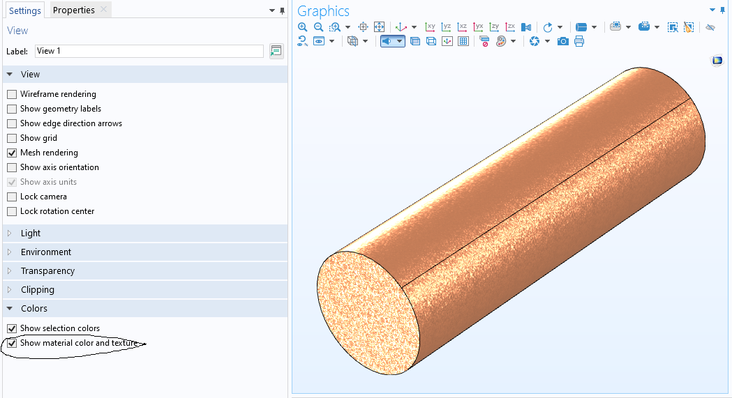

How to display material appearance in COMSOL 5.6?
In earlier versions, this can be done in Preference->Graphics and Plot Windows, but in 5.6 where is it?
2 Replies Last Post 2021/09/01 10:28 GMT-4
Magnus Ringh COMSOL Employee
Posted: 4 years ago 2021/09/01 9:33 GMT-4
You do it in the Settings window for the View node (see the attached screenshot), but you can also do it from the Colors menu in the Graphics toolbar above the plot. In the plot I have chosen Rose gold (dented) from the Material type list in the Settings window for the material.

Hi, You do it in the Settings window for the **View** node (see the attached screenshot), but you can also do it from the **Colors** menu in the **Graphics** toolbar above the plot. In the plot I have chosen **Rose gold (dented)** from the **Material type** list in the Settings window for the material. Best regards, Magnus

Thank you, Magnus! The setting is so flexible.
