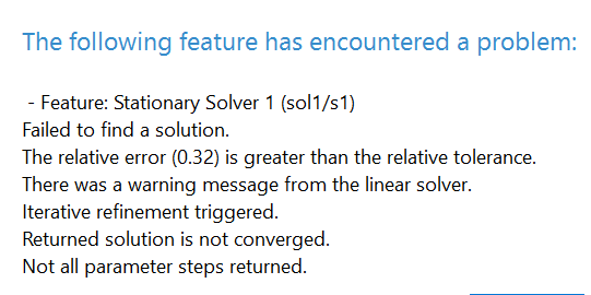

See the attached png file for the error I get.

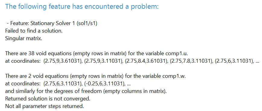

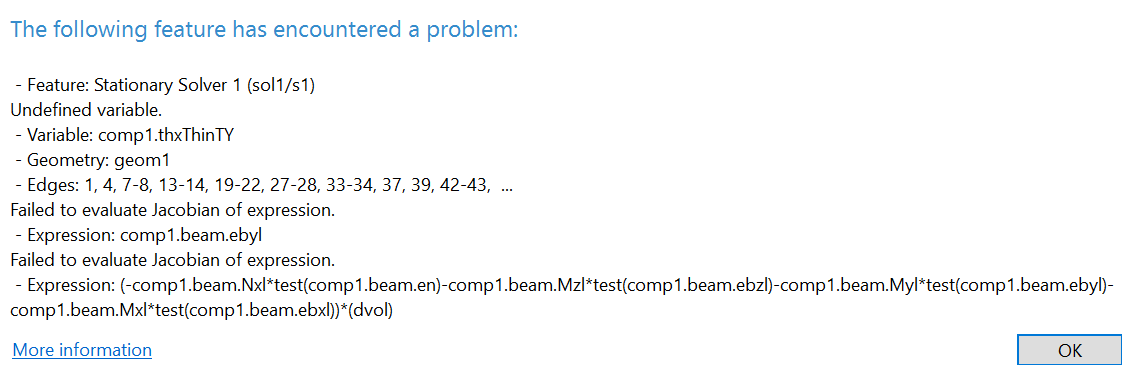

Hi, Thanks for your reply, that error is now gone. But I still have another error, please see the attached file. It seems as I have some error in my geometry which makes comsol unable to compute a specific variable used in the calculations, but I can't understand why.
Posted: 4 years ago 2021/09/07 16:51 JST
This seems to be a bug that we will have to look into. Please try putting the Beam interface before the Truss interface in the model tree, and see what happens. Please report back here.
Henrik Sönnerlind
COMSOL
Posted: 4 years ago 2021/09/08 17:03 JST
Putting the beam interface before the truss interface seemed to help, definitly seems like a bug(?). However now I have a third error, see the attached png file. I made a very simple truss and beam model, which I also have attached.
Posted: 4 years ago 2021/09/08 18:36 JST
The model you have attached is not statically determinate (stable). It has two rigid body modes, something that you can see by computing the eigenfrequencies.
Henrik Sönnerlind
COMSOL
