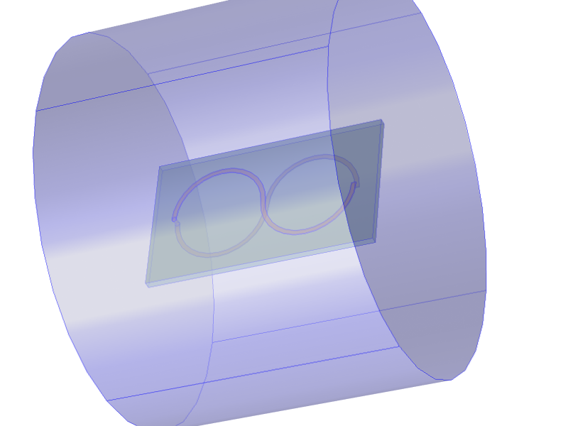

Thank you for this suggestion. When I try a scattering boundary condition instead of an impedance boundary, there is a similar error (below). My initial question should have been this:
How can I calculate eigenfrequencies, including the imaginary (loss) term, for a circuit board RF resonator.? Some of the loss comes from the circuit board substrate, and this is easy to include as an option in the wave equation (electric displacement field model). How can the loss fom the conductor resistance (including skin effect) be included? Also, should the circuit board traces be modeled as infinitely thin boundary layers, or should they be made with some thickness so that COMSOL's solution automatically includes skin effects?
An image of the model is attached, including the cylindrical simulation domain, rectangular circuit board substrate, and top and bottom conducting traces.

I appreciate your taking a look at this. I used thicker copper layers in an attempt to include the skin effect. How would COMSOL know if my circuit traces are thinner or thicker than the skin depth, unless I make them 3 dimensional?
The bulk copper seemed appropriate, and then COMSOL complained that I should specify materials for the conductor boundaries, too. That is why there is bulk & boundary copper.
I just want to know the eigenmodes. That shouldn't require source terms or ground...
A cleaned up version of the model is attached.
Have a nice weekend,
-Till

I believe you are doing double up then, as for me: either you define the current flowing in the skin = boundary, and you ignore the domain (bulk), or you solve it fully in the domains (and ignore boundaries as materials) and the EM equations will force the current to flow in the skin depth region of your domain, the latter is certainly heavier to solve but more general.
So I would suggest choose one of the two: boundary or domain approaches.
I'm not sure how to interprete the eigenmodes if you leave V fully unconstrained.
It's like solid and eigenmodes, you do not need to fix your object in space, but if you do not, then the 6 first rigid body modes are all "0" and the others are free-free modes, but they are very different from a fixed-free mode you get when you constrain one boundary to get a fixed reference
I would say you must have a ground "plane" somewhere, but probably it could be on an external boundary
