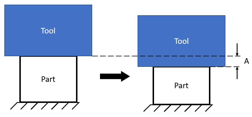

I need to simulate a sinusoidal displacement that is imposed by a tool to a solid plate (see image). The amplitude (A) is 50 and it moves at a frequency of 50 kHz. I tried with prescribed displacement, but it does not include the option of frequency. I would appreciate any help. Thank you.

you can run a frequency domain study and the prescribed displacement will be applied at the study frequency.
