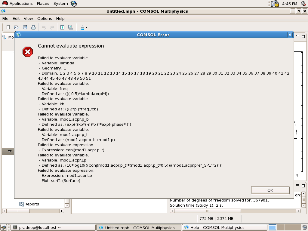

I am trying to simulate for acoustic cloaking in Comsol 4.2.but there are some errors. I cant understand how to remove those errors. I have attached the screenshot of comsol error here.
Please help me out..

are you sure you have defined a frequency in the frequency domain solver ?, that is what I suppose from the error, but it's difficult to really know only from that snapshot ;)
Hi are you sure you have defined a frequency in the frequency domain solver ?, that is what I suppose from the error, but it's difficult to really know only from that snapshot ;) -- Good luck Ivar
