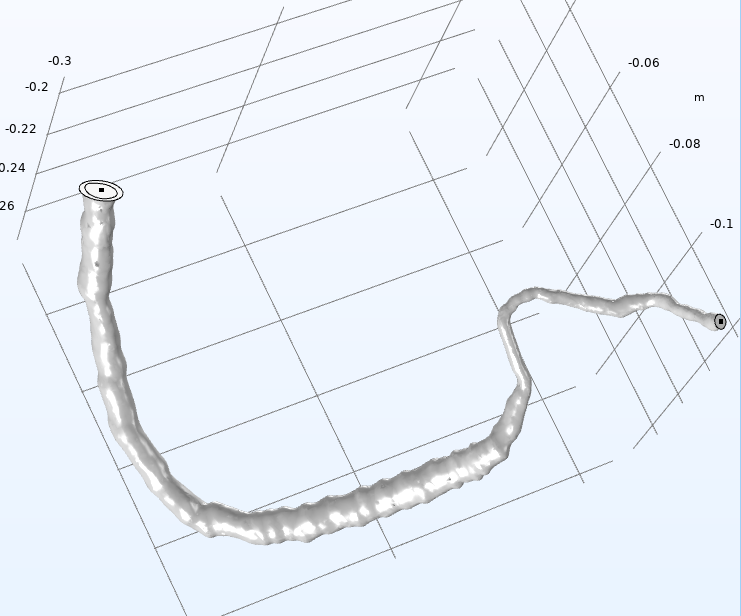

                                                    Hello Mathias,
This is a bit of an odd question for me to ask, but how do you define the centerline in this case? It would seem that you could create different curves that all run approximately down the middle of the artery but all differ from one another slightly, depending on the exact way you create them.
In any case, I have a hunch that you could create one such curve using the Wall Distance Interface (see this link ) in some way.

                                                    Hello Jeff,
thanks for the advice. I am aware that the different curves might differ from one another but thats fine for the purpose I am using it for. Unfortunately I couldnt figure out how to implement the Wall distance interface in a proper fashion since I am unsure how to set up the correct values for distance equation, periodic condition, wall distance continuity etc.
Is there a way to extract the coordinates of a streamline thats close to the center somehow? This would be sufficient for my simulation so I can use it to sweep the "outer arterial wall" and assign material properties along that "tube".
I appreciate your help

                                                    Hi Mathias,
Perhaps I should have asked you what you need the centerline for. Because if what you ultimately want to do is to turn your single domain into one that represents the wall of the artery and one that represents the inside of the artery, then there is a very easy way to do it that does not require the centerline: use an asymmetric Thicken operation. The attached file illustrates what I mean, with your complex shape replaced by a cylinder.
