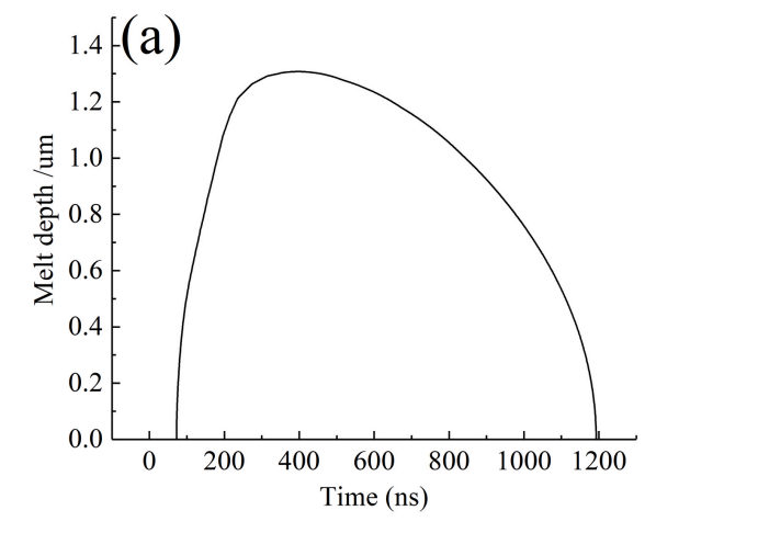

I am trying to determine the melting depth in my material as a result of my heat source.
The result I aim to obtain from COMSOL is of this plot.
Can someone give me an idea on how to obtain it?

I have checked it out. Is there a mathematical expression to call out the melt depth in the result section?

You may try integrating a function which is 1 in the liquid and 0 in the solid. Let Tm be the melting point. Then the function is:
if(T<Tm,0,1)
and the liquid depth is:
intop1(if(T<Tm,0,1))
