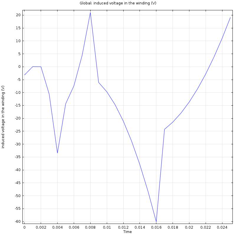

I want to test if the voltage inducted at no load and at 127rpm is like the results of an article i have but as you can see my simulations are not giving a sinusoidal voltage (as it should). I tried to make almost every example of the AC/DC module but i am not getting any good feedback where my error could be. Anyone have an idea? I have attached the files.
Could the error be in the type of the system solver? I am using the default "Direct(UMFPACK). Is there other more apropriate for this "moving generator"? For the time stepping i am using "linspace(0,0.03,30)".

at 127 rpm and 32 poles it takes only 0.015s to rotate from 1 pole to the next. Is your time stepping too coarse and you are observing just an aliasing result?

As i said i am using for time stepping "linspace(0,0.03,30)". I have already increased it for linspace(0,0.03,100) but the bad induction presists. I thought that with more steps the problem should be gone but it didn't. Is this what you are suggesting?
Do you think that i should increase it even more?

Sorry, I got the syntax of linspace confused. The time stepping is probably ok. You might still check if you chose explicit timing in the solver.
Another issue might of course be the meshing.

I think what i had was indeed a aliasing result. I can get now a sin wave for my induction voltage.
