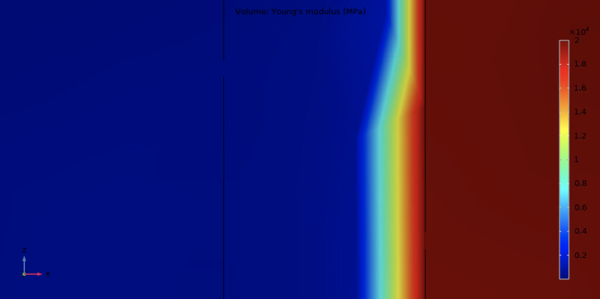

I am attempting to declare a material property (young's modulus) as a function of the x coordinates of the model. The function is an interpolation function titled E, so I inputted a table that corresponds to the x values and their respective E values. Then, in the material declarations, I input E(x) as the value for the young's modulus. When I build the model and check a 3D volume plot of the young's modulus values of the object, the values are also changing as a function of y and z coordinates. Additionally, the value on the model does not match the value in the interpolation table. For example, at x = .004, E should equal 312. But instead, at x = .004, E = about 327.

For example, with the x-coordinate being moving to the right, I should not be seeing the change in young's modulus values in the z direction that is clearly seen in the image when I call young's modulus as E(X).

I don't really see the effect that you observe. Perhaps a volume plot is not the best view of the Young's modulus. In the attached model, I have added three Cut Line 3D datasets for plotting line graphs in the x, y, and z directions. Only the x-direction plot shows a variation. I have also added a Cut Point 3D dataset at the location (0.004, 0, 0), and evaluating solid.E at that point gives a value of about 312 MPa.

Magnus, Thank you for your help. I think my choice of volume plot was not the right choice to view the young's modulus behavior. I believe I am implementing my equation correctly in my model based on the results of the Cut Line 3D and Cut Point 3D choices. Thank you!
