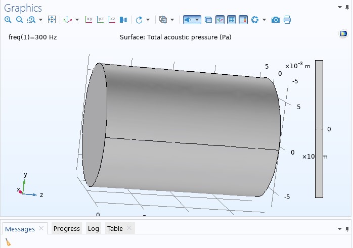

Hello everyone I have a problem with my work. I want to simulate the variation of frequency in a porous material, but there is no variation appearance of my work. There is nothing. How can I do?
1 Reply Last Post 2021/12/07 7:27 GMT-5
Posted: 3 years ago 2021/12/07 7:27 GMT-5
For this 3D plot you typically look at one frequency only. If you want to look at a frequency response, you make a 1D plot.
