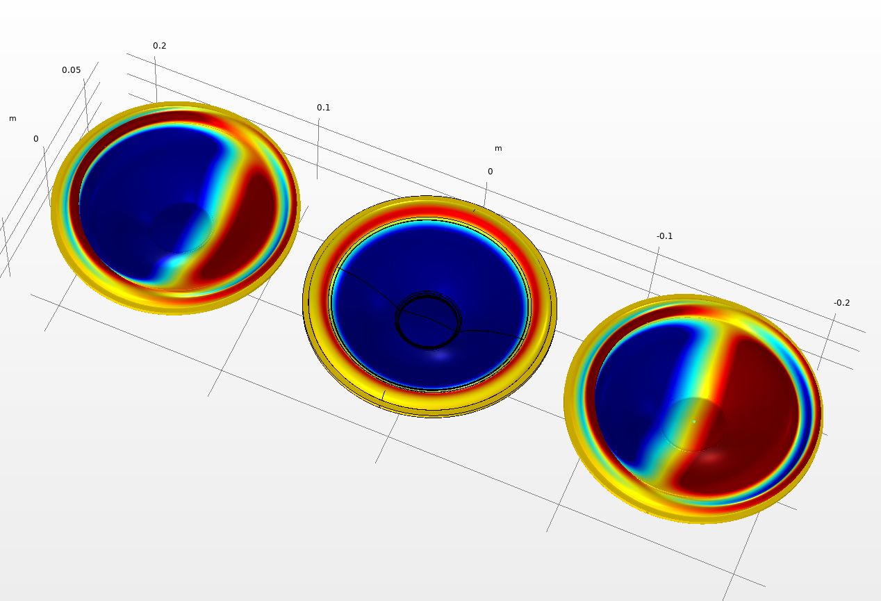

I'm in the process of developing a loudspeaker application in which one of the main steps is to calculate the average displacement along "rings" in a loudspeaker cone, in order to project that average displacement into a 2D axisymmetric model. That is, for every point along the edges of an axisymmetric shell model, there exists a three-dimensional ring which, when evaluated, provides the average displacement along itself as a form of projection to the 2D axisymmetric domain. The image below demonstrates what I mean... Averaging occurs in the direction of those arrows, eventually projecting the results in function of the z-coordinate.
Example of the direction where averaging takes place
Therefore, more exactly, one way of stating this projection is to say that I want to be able to feed into another component, in the z-coordinate, the results of the z-axis displacement evaluated along the rings in the 3D comp, such that for every z-coordinate in the 2D axisymmetric component,

It may help to make sense if you remember that this is taking a 3D shell and "revolving" it down to an edge. This can be further simplified and thought of averaging all results in a horizontal plane at height 'z' at all available coordinates and making this averaging operation available in the 2D axisymmetric domain, also along the z coordinate and irrespective to the r coordinate.

I recently went through something very similar https://www.acculution.com/single-post/axial-symmetrical-decomposition-in-comsol-multiphysics. It takes some abstraction to figure out how these mappings work, but it made sense in the end.
I don't think though that the effect of your mapping here is integrating in circumferential direction, so try putting it to the test with some cases with distinct radial and circumferential behavior.
