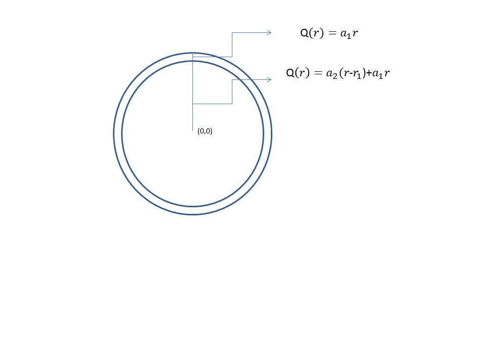

I am trying to solve a simple heat transfer problem, where I have to define the rate of heat generation as a linear function.
Please see the attachment, here a1 and a2 are constant and rate of heat generation is different at the sections which is represented in terms of equation.
Request you to please see and let me know how to define these linear functions in FUNCTION.

Solution is :
The equation for heat source is defined in the analytical
function and this analytical function is used for providing the heat source
in the Heat Transfer in solids physics.
