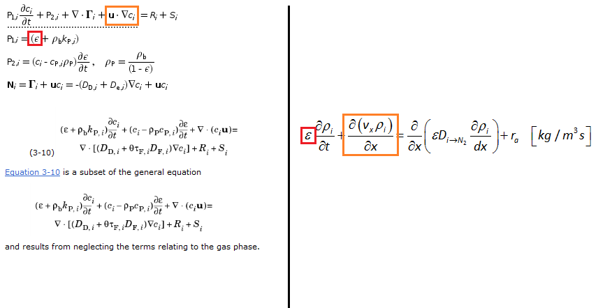

I have a question about the Species transport in porous media equation. The porosity term epsilon is only present in front of the dC/dt term. However, I do not see it anywhere near the convective term. I think I have seen papers where they did put the porosity also in front of the convective term.
Why is the porosity not in the convective term?
I included the equations from COMSOL and I included my equations, written as a mass balance (for more clarity). They should be the same, currently without the porosity in the convective term.
I hope anyone can answer this. Thanks a lot and kind regards,
Ray

Dear Juergen,
thanks for your help :) . I am however not entirely sure this is about the same thing. From what I can tell, the text you found explains how to calculate the Darcy velocity into the interstitial velocity. But I don't really see how this connects to the question if the porosity should be in the convective part of the differential equation.
I do appreciate the help though ;)
I wonder where COMSOL has based their equations on, isn't there a reference list somewhere?
